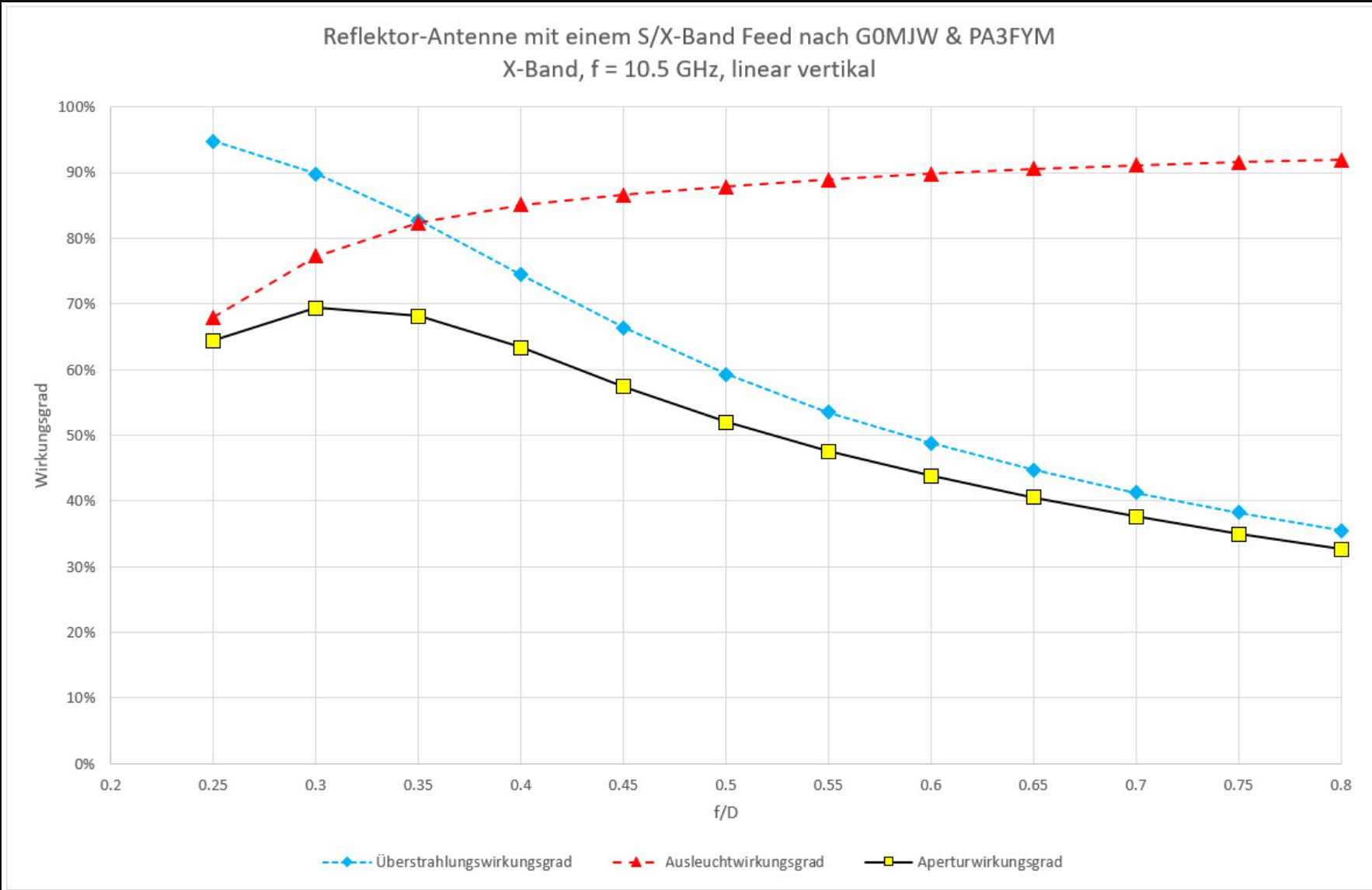

The feed is not designed for a 0.38 F/D antenna and will be less efficient - but not that bad if accurately reproduced.. It should work on RX but you have to be at the correct focus and it is very critical with deep dishes. Adding the lens should not make it better, unless it compensates for the focal length.
Willi, HB9PZK did an analysis:
10 GHz without a lens:

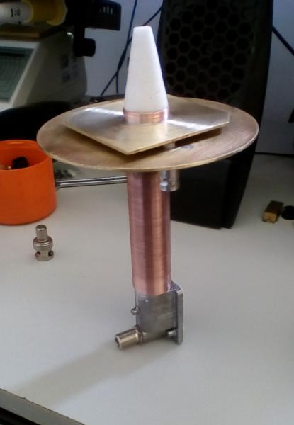

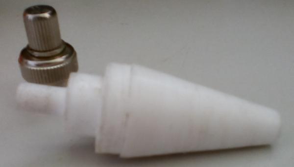

OK PTFE rod arrived today and I found it a very awkward job to do indeed, PTFE does not hold well in metal lathe jaws, so I think I would recommend buying a rocket LNB and butchering that for the lens.
Nevertheless.
and
So next to do is a simple adaptor for 40mm and give it a try. I think the 105mm disk may fowl the support arm in which case a rethink on the support, but I want to see what difference it makes to RX comparing the beacon.
