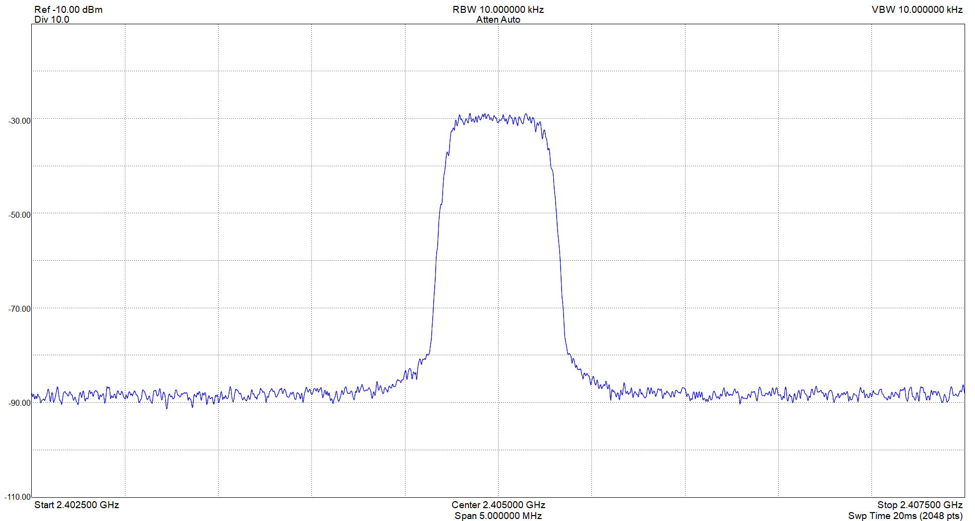

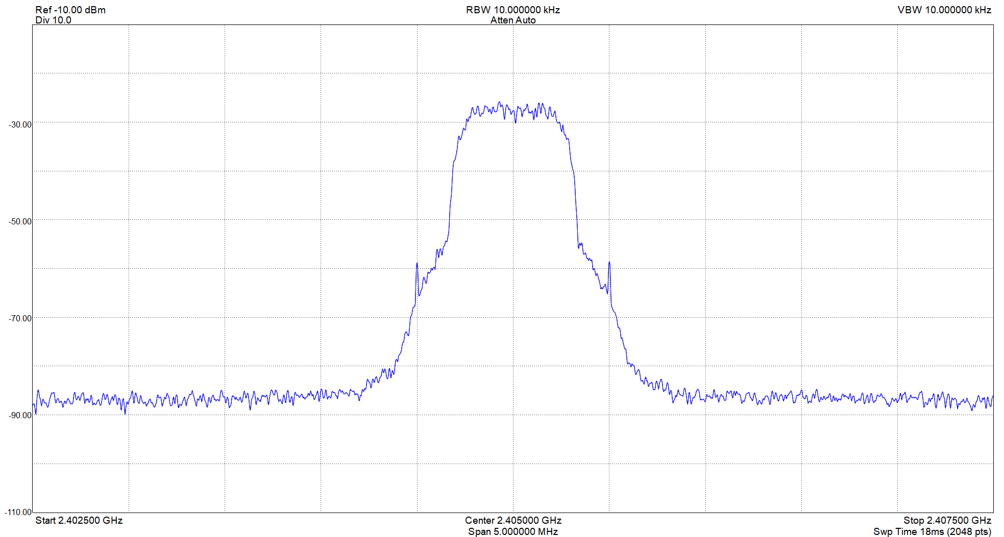

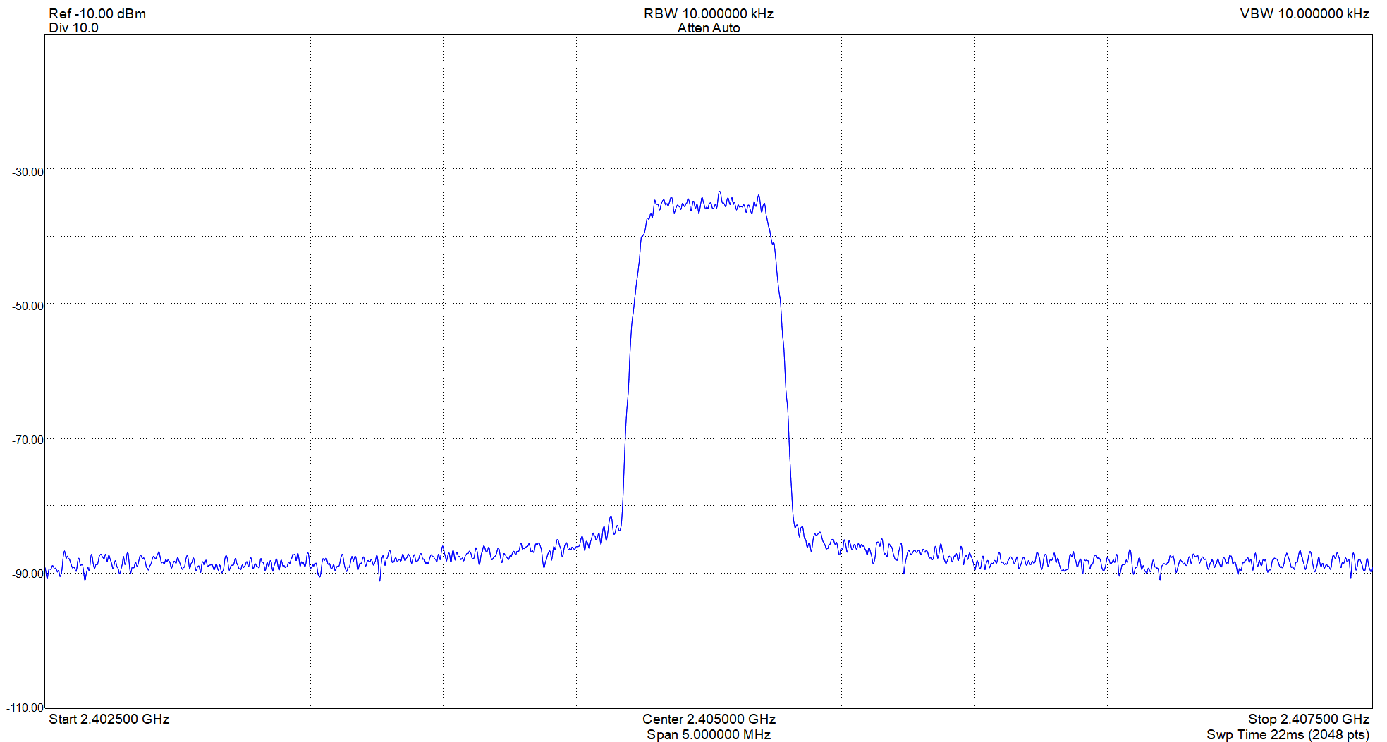

I just compared my Lime, Express and Pluto at 500 K using the datvexpress software (I couldn't get the Pluto output as high as the other two)
but while my Lime is not as bad as your's it is somewhat worse than the other two.
I tried reducing the Lime output and it didn't make it any better.
The spectrum analyser was a SignalHound BB60C
Lime
Lime
Express
Express
