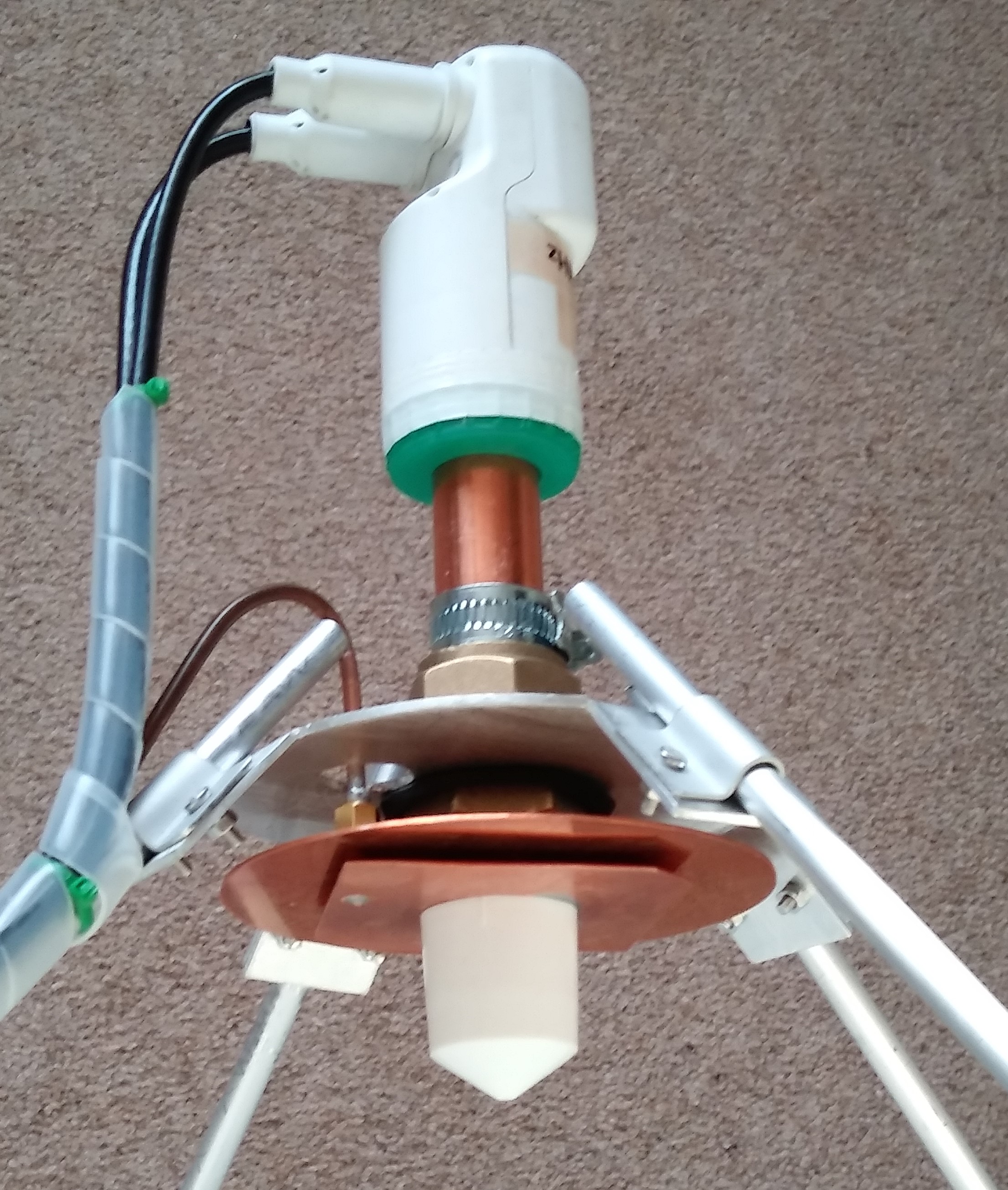

Hi all,
I have attached a photo showing the white cap lens feed from the AB LNB 01 in place on my dual band feed. During integration of the antenna feed, I tried reception without and with the lens. Bearing in mind that the prime-focus dish used in this case has an f/d = 0.4, the lens may not be needed - one thought. But in the reception test performed, the 10-12% BER without the lens was reduced to about 4-6% BER with the lens, so the lens was deemed beneficial. The original dish feed had choke rings to reduce feed side-lobes and I believe the the lens does the same job to reduce side-lobe noise pickup.
Jen G4HIZ

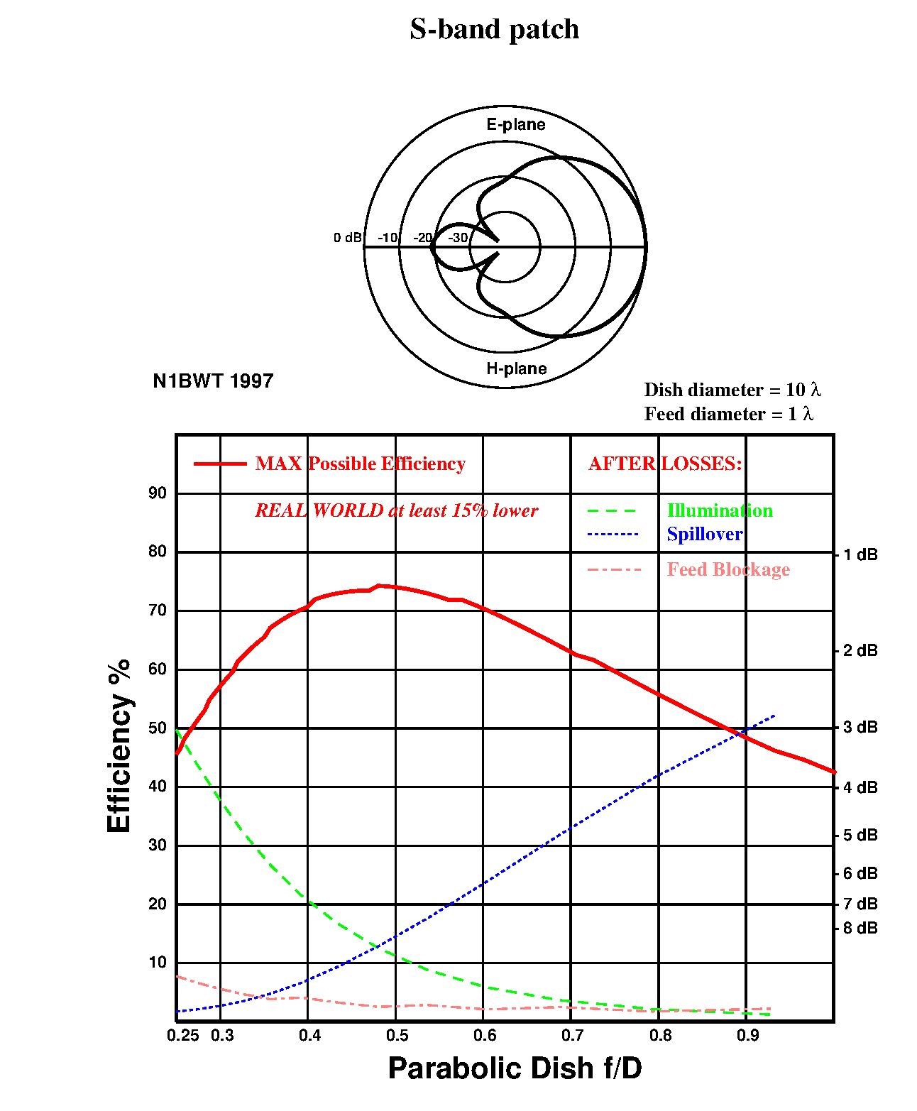

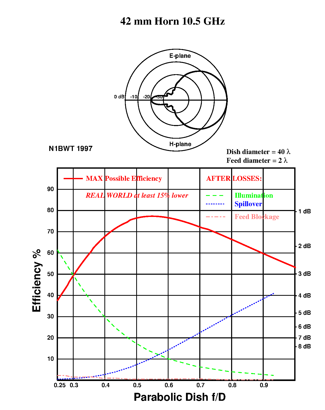

A 0.4 F/d is not really suited to the lens - so glad it is working.
For s-band it will be good. This is what W1GHZ predicts for the S-band patch - its best at 0.5 but OK at 0.4 and 0.6. Don't forget in practice it will be 10-20% less efficient than predicted here as there are no losses included.
Here is what a typical small horn (my 42mm plumbing fitting) might be like.
Very much designed for a higher F/d. It is about right for a 0.6 f/D which is just as well as that is what it was designed for. I would expect to be at least a dB down on a matched feed. The one to use would be the VE4MA feed like the original. I don't know how much it would detune the patch though. The notched disc would be better.
If the rocket lens is giving a good result stick with it. Note also that the broadcast transponders and amateur will be different. That's because there are adjacent satellites in Ku band that may limit the signal to interference ratio whereas there are no interferers (yet) at 10.5 GHz so you are looking at pure signal to noise. Under illuminating the dish will reduce sidelobes and reduce the noise, but it will broaden the beam to if there were adjacent signals they would not be rejected as well, but there are none so it doesn't matter. Hoping this makes sense.

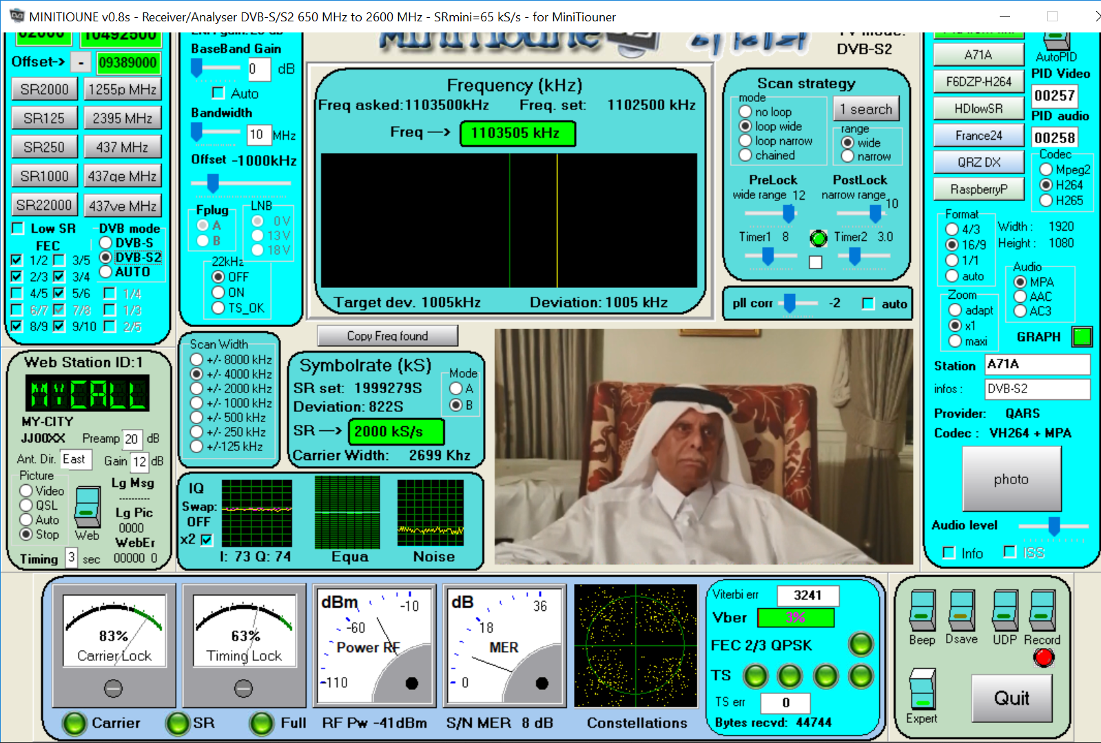

Hi all,
as concerns the AB LNB 01 lens shown in my earlier post. You can see typical reception below for my 90cm centre-fed, f/d 0.4, antenna - MER 8dB for the WB beacon. [LNB Octagon with locked 26MHz xtal. Receiver: Sharp Minitiouner running v0.8].
Jen
