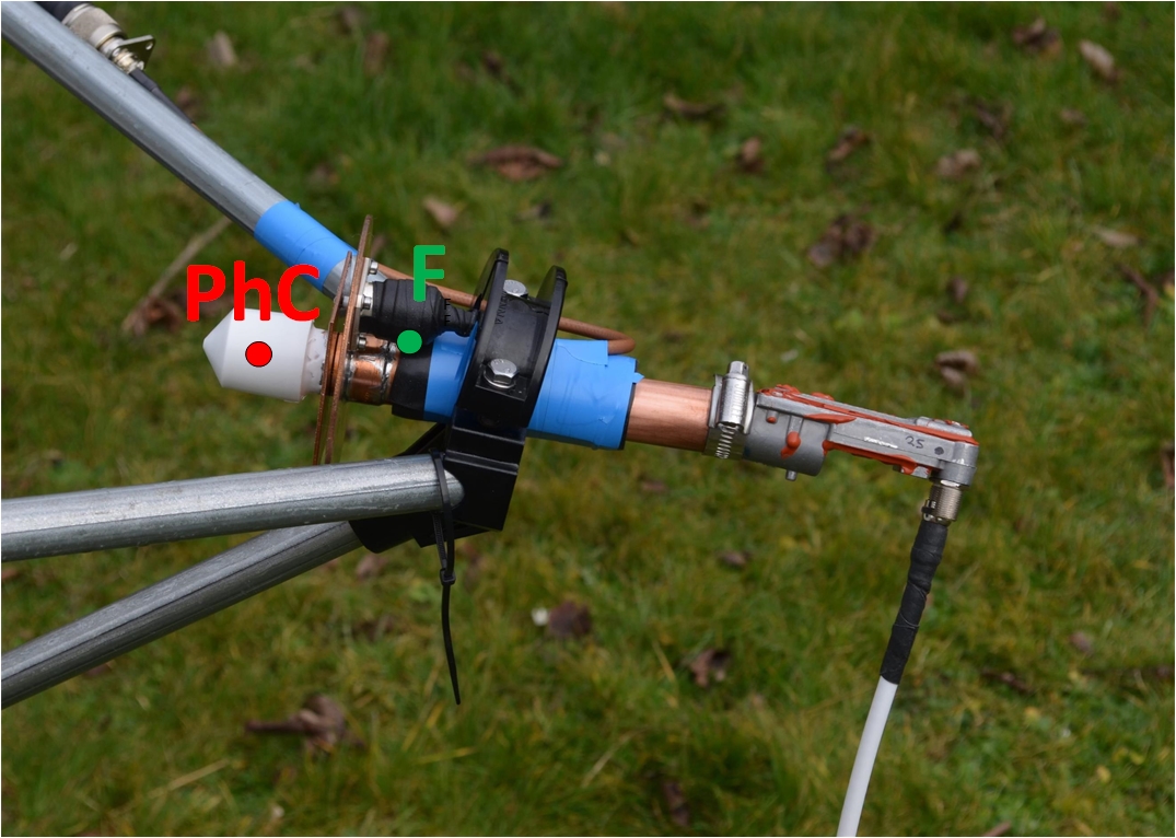

In last couple of days I got messages from 2 different users of this forum @2W0ODS and @G4GUO, both were pointing me to this thread. So, I am here and, TBH, delighted to see some of the CM LNB-holders I made in use by other users. When I designed the holder I was thinking of just holding Ku, Ka or C-band LNBs. In case of dual-feed LNB most of you guys using, this INOX holder will surely fit better than original CM plastic holder..... but it will still not provide perfect solution. I will try to explain this on the base of Charles' picture.
The main issue here is the fact that LNB's Phase Center (red dot) is not co-located with antenna's Focal point (green dot). The new LNB-holder will probably do better but, again, not perfect. To get maximum performance of your antenna-system more radical approach is needed, namely “feedarms should be changed” . I have changed feedarms on CM dishes and if there is interest I could explain how to do that.

In last couple of days I got messages from 2 different users of this forum @2W0ODS and @G4GUO, both were pointing me to this thread. So, I am here and, TBH, delighted to see some of the CM LNB-holders I made in use by other users. When I designed the holder I was thinking of just holding Ku, Ka or C-band LNBs. In case of dual-feed LNB most of you guys using, this INOX holder will surely fit better than original CM plastic holder..... but it will still not provide perfect solution. I will try to explain this on the base of Charles' picture. DualFeed.jpg

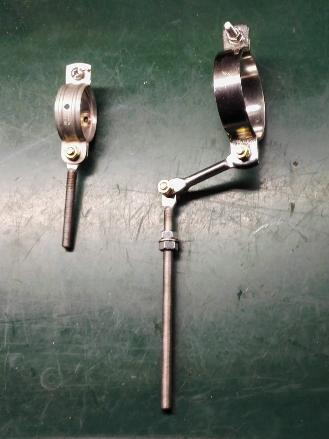

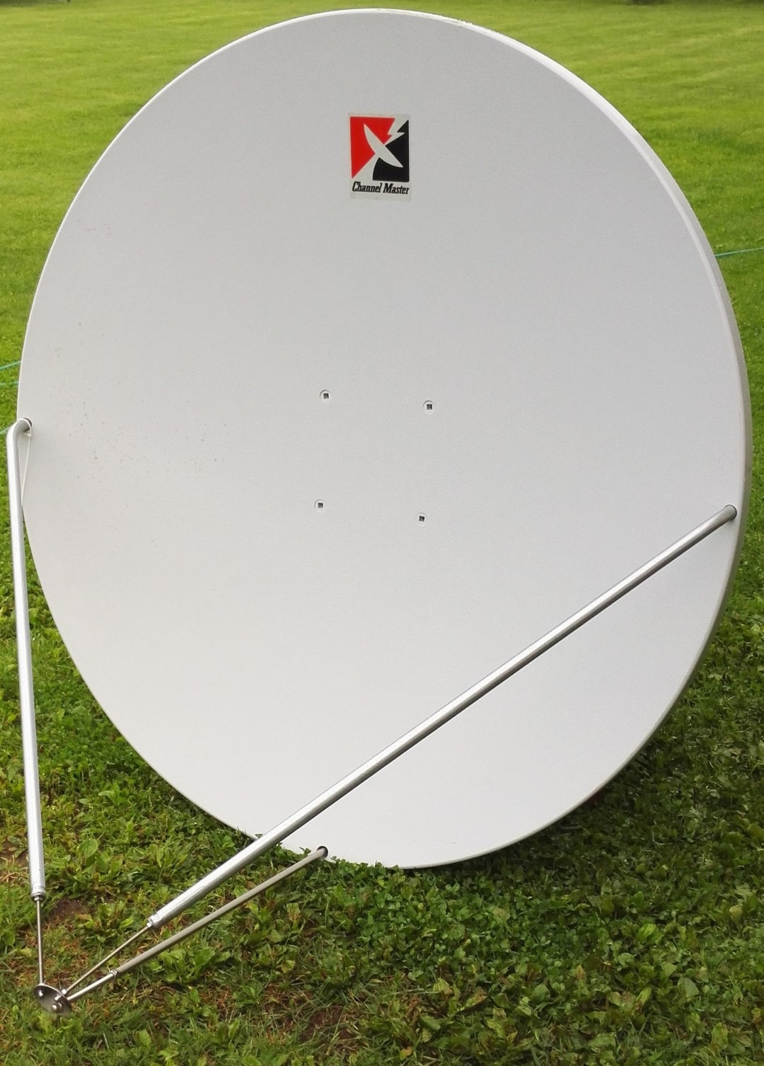

There are some self-explaining pictures of extendable feedarms. Image Image Image Image Image Image Image
For antennas up to 1.2m 10x1mm pipe is more than enough. Of course, instead of 40mm clamp (Ku-band LNB) it is better to use clamp which can hold 22mm LNB neck.
