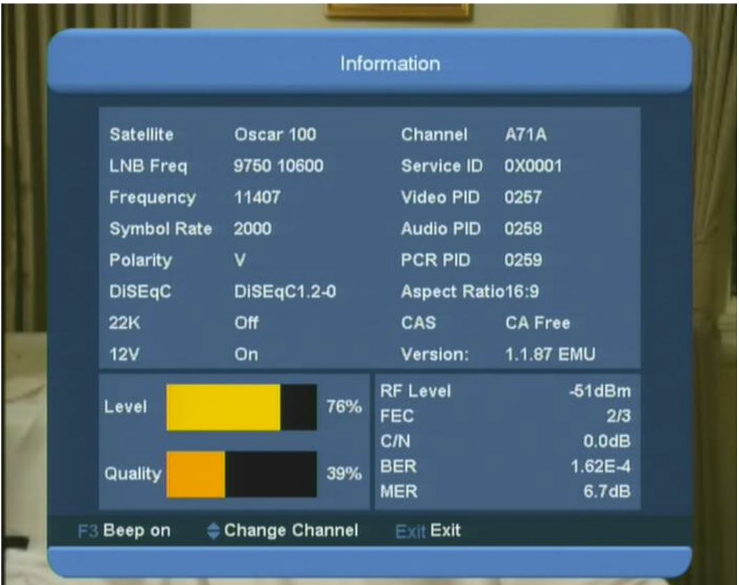

Capture Satellite rx with 2400.JPG (81.43 KiB) Viewed 3011 times
This is the information page from my satellite rx when using a SUP-2400. Note that you will need to supply 18v to the LNB. The SUP-2400 modified does not do that but an unmodded one might be OK.
