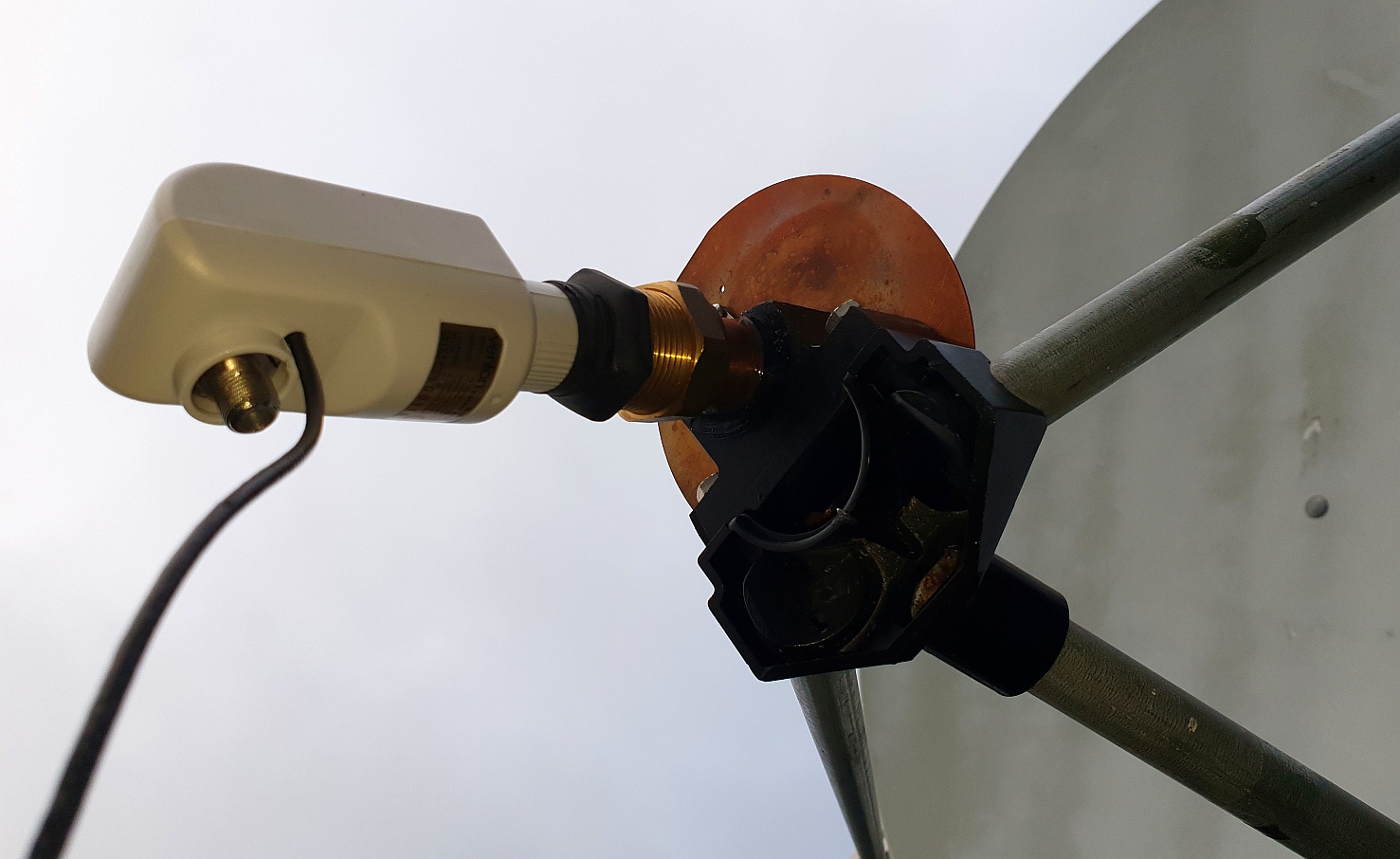

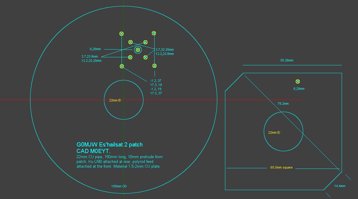

Hi all, had a few requests for the CAD dimensions for the patch that Mike worked on to design, so here it is.
From tests it certainly appears to be a good LHCP.

- patchdims.png (46.77 KiB) Viewed 9198 times
- esh2_feed.jpg (346.73 KiB) Viewed 9198 times

Simulations indicate this will work well but it may not immediately match as it is sensitive to getting the dimensions right. Working to 0.5mm tolerances is difficult with hand tools. A good match can be achieved with a little tweaking once built if you have a VSWR meter for 2.4 GHz.

Paul, could you post a drawing with location dimensions for the feed on the patch? Scaling off a scaled print does not match with what's shown. I can then 3-D print a guide template and give it a go with a file.

From what I have gleaned on building this feed, the patch spacing is 3mm above the 105mm diameter ground plane and enought 22mm pipe needs to protrude out in front of the patch to allow securing the Rocket LNB red cone.
Behind the ground plane if doesn't matter much how far the LNB is mounted, but like anything RF, the shorter the better?
So planning just enough to fit a mounting collar around it....
I plan on mounting the amp directly underneath on the underside of the LNB arm with a short link of SMA-solid coax-SMA.
Any thoughts or guidance before I commit soldering?
