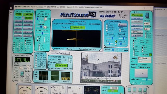

Hi Noel
Going to try my mini tioune to find it but I do not understand how to use the OFFSET in the minitioune s/ware.
I assume this is the LO freq on the LNB.
Nick
Nick
Re: Es HailSat 2 location
My Dad always said to me...
If at first you do not succeed try and try and try again,
I gave up with the V8 finder.
I put mini tiouner s/ware on the lap top.
Set it up and ... Eureka ......
I think I have it.
Too dark to do any more tonight.
Nick
I think I have it.
Nick
- 20180903_203009[115365].jpg (133.04 KiB) Viewed 7474 times

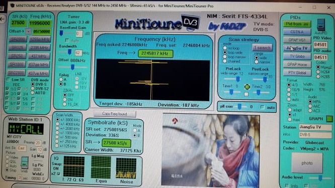

This one did not upload showing levels
obtained pre tweaking maybe tommorrow....
- 20180903_203022[115366].jpg (119.44 KiB) Viewed 7473 times
Umm - I'm not sure that is BADR4 - they look like "Asian" channels rather than Arabic and the service provider displayed in the "station" box says PTV which is Pakistan TV which is probably on Eutelsat at 9 degrees.
http://www.satellit-key.ru/satellite-tv ... m-pakistan
Also, you have a 9750 offset rather than 10,600 which you require for the higher channels - this is the reason I used a STB as an easy way to give the correct voltages and offsets:
I use Lyngsat to try and identify what transponder you are on https://www.lyngsat.com/europe.html
To receive Vertical transponders you need 12v on the LNB - for Horizontal you need 18v on the LNB.
For channels between 10,700 MHz and 11,900 you use an offset of 9750 MHz in MiniTuioner or the STB.
For channels between 11,550 and 12,750 you use an offset of 10,600 PLUS a 22KHz tone to switch the LNB to the high LO - I'm not sure if MiniTiouner does produce that on the LNB F type plug...
So for the BBC Asian channel on BADR4 on 11996 MHz Horizontal you need 18v, 22KHz and an offset of 10,600 as well as 27,500 SR and 3/4 FEC
Hope this helps
Hope this helps

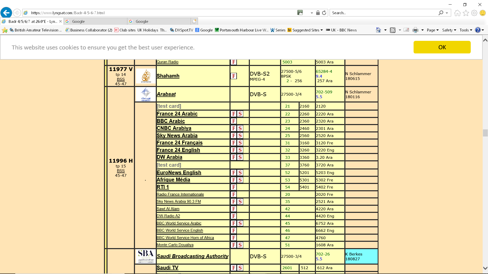

Hi All
I have been receiving Badr at 26E for 8 months now using a 1m offset dish and a Technomate TM-1 LNB ( claimed 0.1db N/F )
Reception is very reliable even in heavy rain, my dish is fitted with a Disec motor which is excellent once you have got it set up. it always comes back to 26E spot on every time.
The MER is between 10db and 11db on the 11996MHz transponder. The LyngSat page for Badr 26E and transponder at 11996 MHz gives the listing shown in the pic attached and agrees with the programs I receive.
As anyone come up with DIY 2GHz feeds for offset dishes that can be made easily and can be fitted to the LNB holder on the dish.
73 Arthur
73 Arthur
- 11996.png (186.31 KiB) Viewed 7424 times

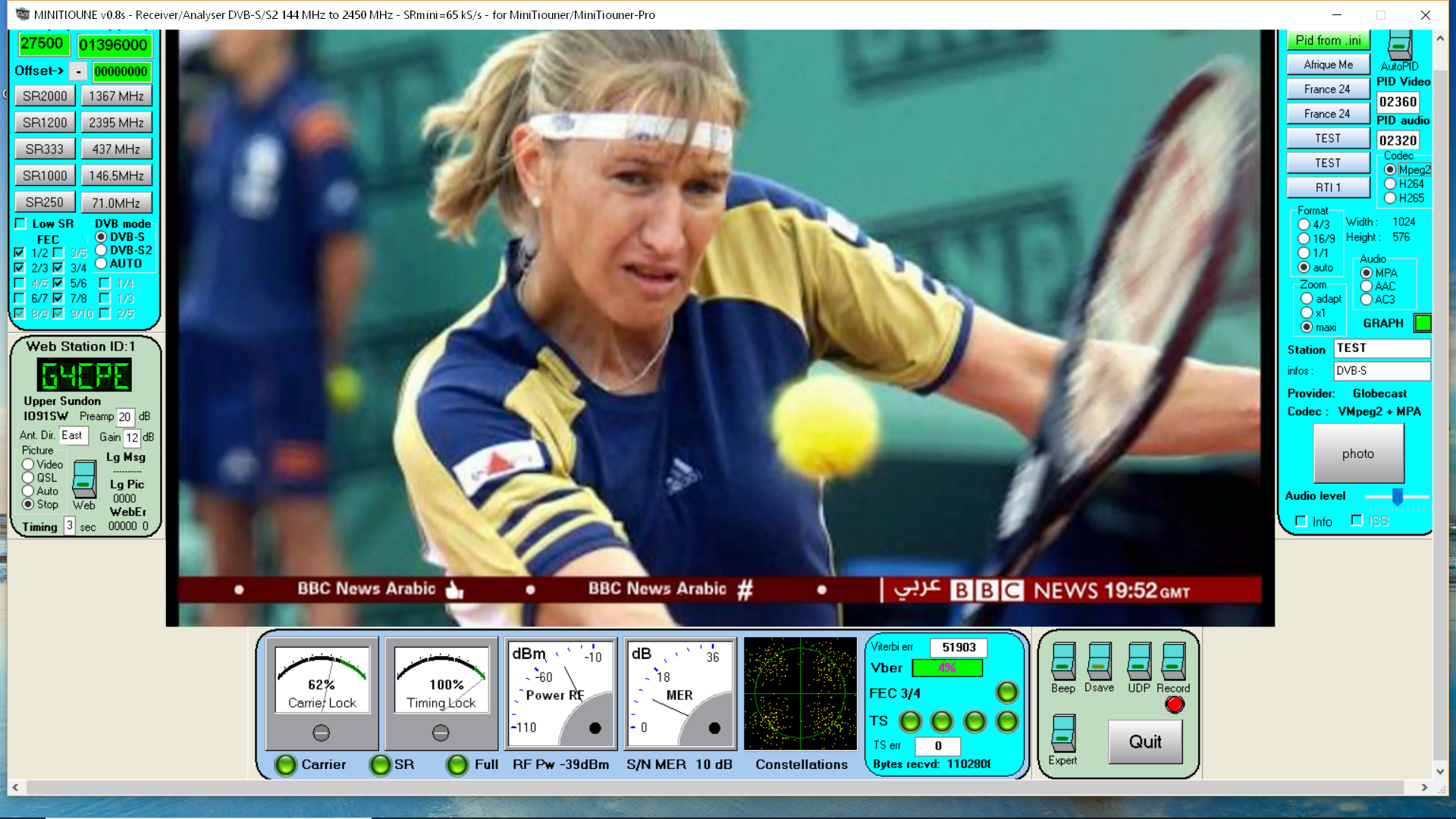

Pic from BBC Arabic on 11996 MHz.
73 Arthur
73 Arthur
- BBC Arabic.png (1.79 MiB) Viewed 7424 times
