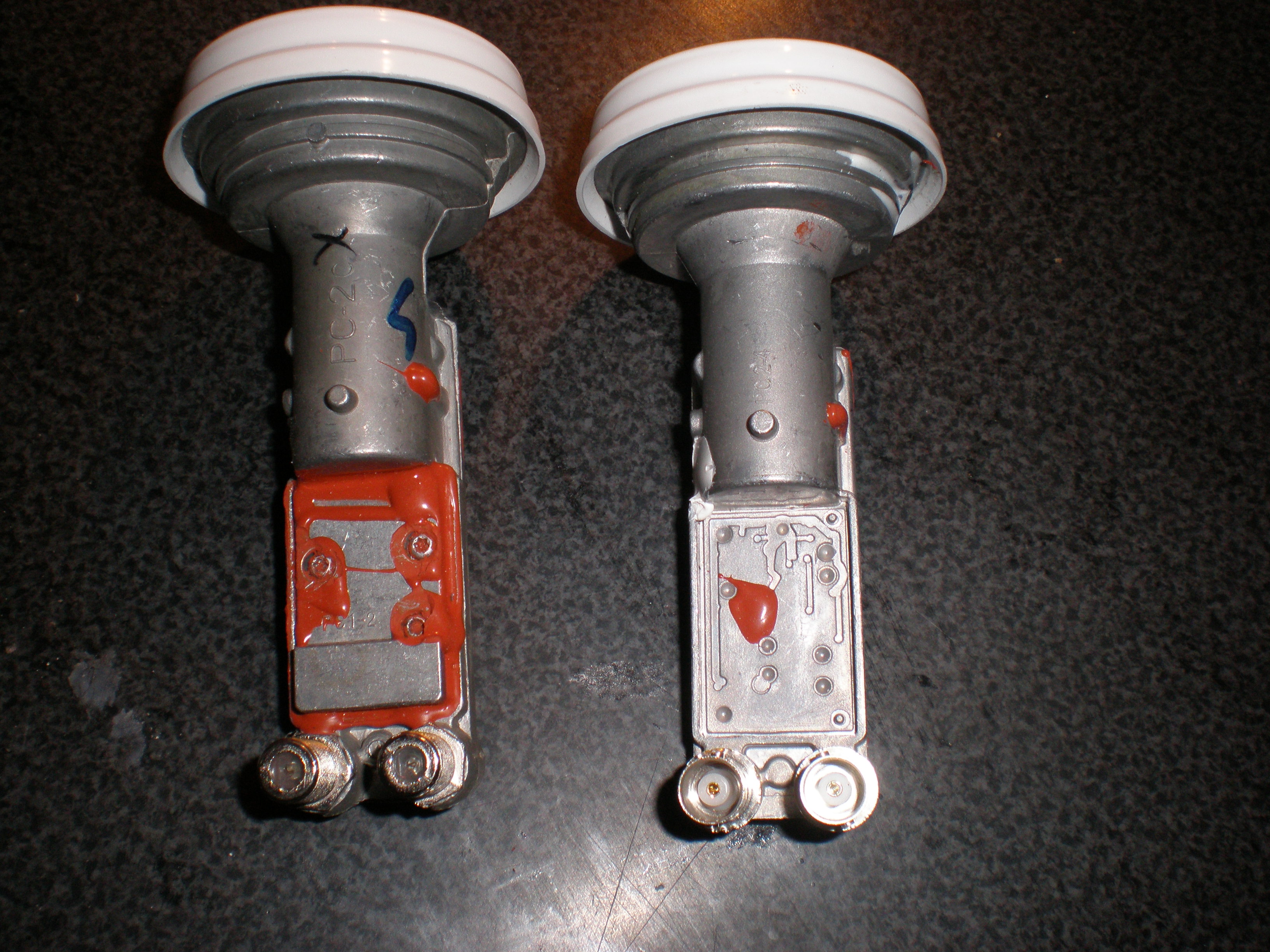

Is it possible to tell if you have the old or new version of the OTLSO, without taking the screws out? Is the metalwork different?

If you are referring to how do you tell the difference between the "single 25MHz xtal" v "two 27MHz xtal" versions without undoing the screws. the 25MHz version only has one housing, on the top. The 27MHz version has two, one on top , one underneath, see enclosed picture in which the 25MHz xtal version is on the right, which also shows my BNC connector conversion
G4FRE

Post by G4EWJ » Fri Oct 12, 2018 7:57 pm
Thanks Dave. I wonder if anyone has done any comparative performance tests on 3cm between the two versions?
