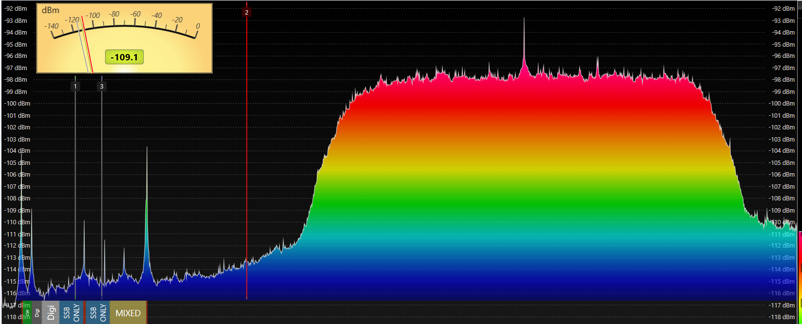

Here is the beacon this afternoon - vertical range greatly extended. Also the NB transponder below, I need to retune my cross polar rejection, but its probably just water on the feed given all the rain of late.
