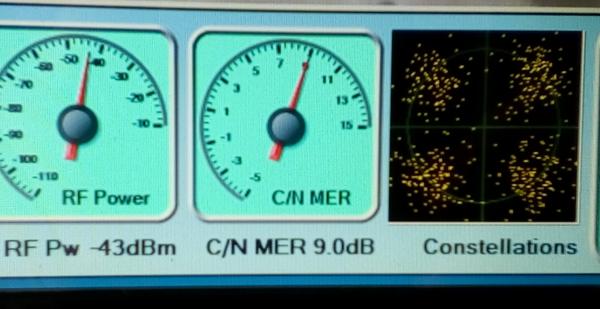

It does foul the support arm so the back face can not go back as far as it should, BUT, I went from a MER of 8.3 to 9.0 on first attempt as it is so the beacon is now a D5/D6 with me from D5, So I guess that my previous best with the standard LNB was not as good as it could be even though I could not align it better.
So possibly some more improvement can be made? Still nothing for TX yet.
The dish is 105 cm by 115 cm horizontal and vertical, so would appreciate knowing if these figures are reasonable?
Now watching the figures drop as clouds get in the way.

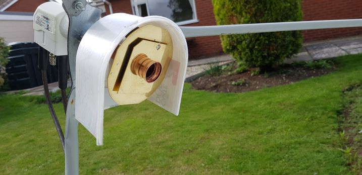

Just an update to my Patch Feed.
I have now added a small horn.
This has improved the receive signal by 2dB approx.
My dish is the cheap 1.8 prime focus.
The transmit and receive are now very good.
The horn made from a cut down plumbing 28mm to 22mm pipe reducer.

These come in other sizes too. I wonder which would be best. The biggest one my Plumbase could get was something like 56mm to 22mm! The cone on the bigger ones might be better. I saw but did not use as my rocket nose is working on my current poty.
The hole will need to have protection as things like bumble bees will find it very tempting as a home!!
