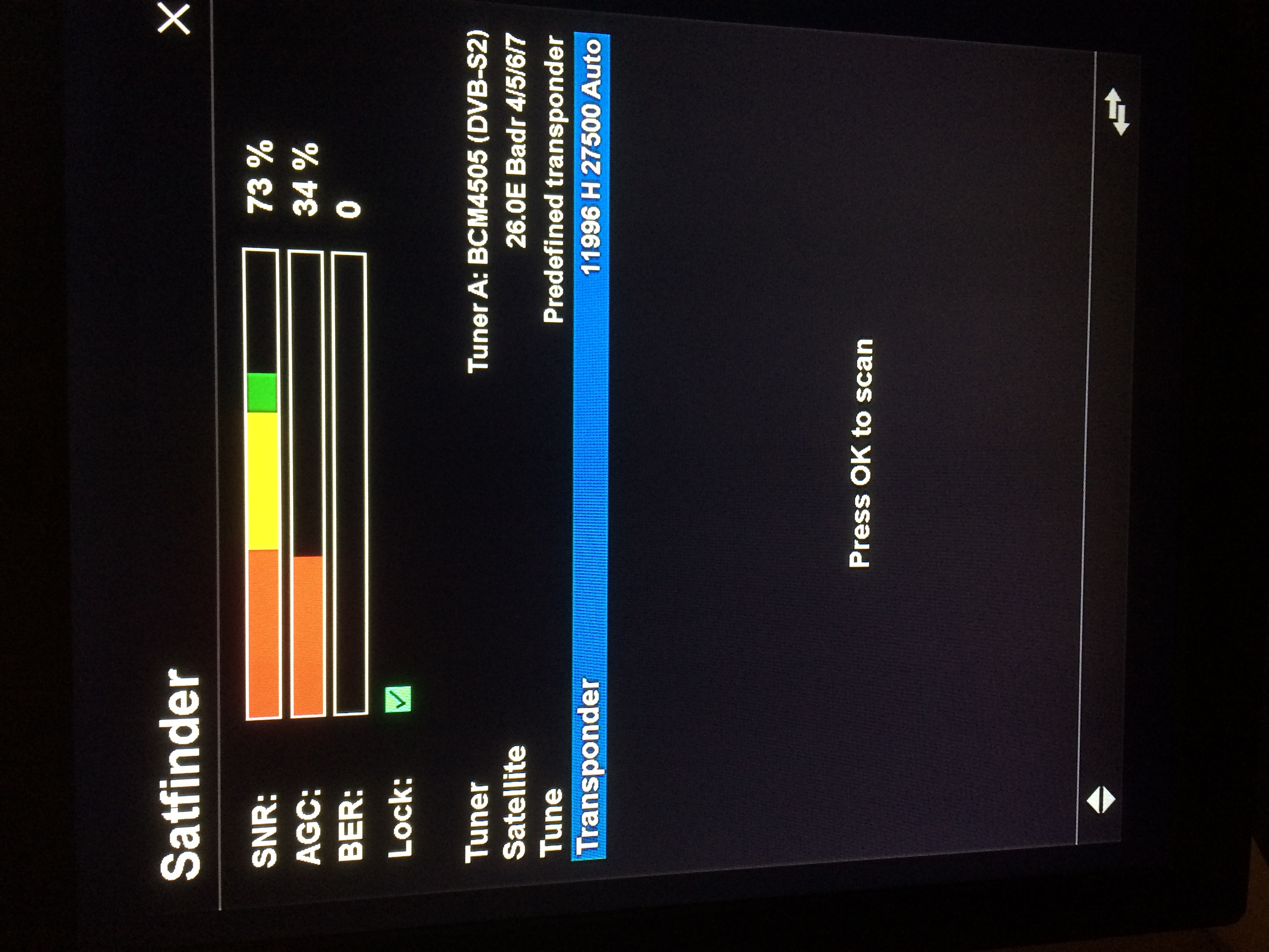

Nope I receive only a lot of BADR4 , see the attachment, Arabic BBC Signal 73%
I have 18V via Bias T on the LNB .
I'm already a couple of day's busy with the settings of the dish, this is mounted on an Technomate 2600 rotor.
its also dificult to know if I have the correct Skew on the LNB
73 ON4CGW Kurt

There's a guide to receiving Oscar100 signals here: https://wiki.batc.org.uk/Receiving_Osca ... TV_signals
Note that a standard sat rx system cannot receive the DATV signals as they are on the amateur band which is ~200Mhz lower thanthe ITU satellite band where BADR4 is. They are are an IF frequency of ~745MHz and so you need a frequency converter or the MiniTiouner USB receiver.
You should be able to see the Narrow Band signals on your RTL stick connected to the LNB via a bias tee at + / - 739.600Mhz
