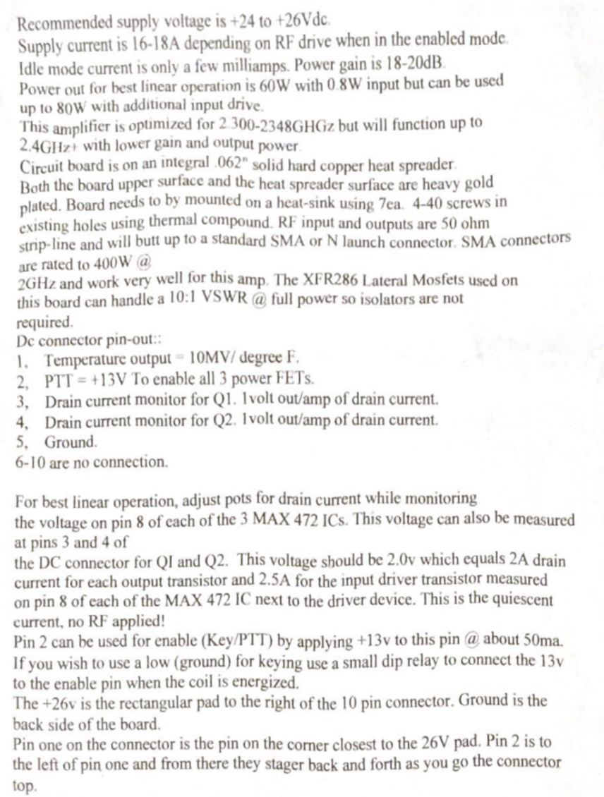

I have a 13CM Spectrian amplifier board which I believe is about 60 watts output this is the board with the three LDMOS devices.
The one thing that I can’t find is the connection details. I have tried using Google lot of pictures but no real useful information that I have found.
Could some tell me the following info?
Power connections.
Bias connection and bias voltage and what to set the bias current too.
There is also a small 10 pin header again is there any useful information i.e. fwd /ref power or temp?
Any pointers or links to find the information would be most welcome.

Google Spectrian amplifier connections - http://www.m0dts.co.uk/index.php?item=77

I have a copy of the notes Pyro Joe sends out with the boards somewhere. If I can find it I will post it here.

Found it. I don't seem to be able to attach files to this post so I have copied it to my dropbox.
Hopefully you can find it here.... https://www.dropbox.com/s/xi461e7oa1rnl ... p.pdf?dl=1
73 Colin.

I had a set of those but I am not in the same place they are at the moment - however I can post an image from your PDF
Spectrian Instructions.PNG (1.14 MiB) Viewed 7968 times
I recall removing the PA devices from many of these boards but there must be many still in people's storage. I only have one left, it is on a DB6NT blown heatsink just about able to handle the extreme inefficiency - I might as well see if it is any use for my QO-100 portable station.

Yes, they do produce a lot of heat especially if running at the full 26V supply. I found you can reduce that to about 19V without loosing much output, and it runs quite a bit cooler.
The mods described in a recent BATC News do increase the output at 2.4 GHz. I can get about 55W from mine running at 19V when it is cold. But that drops to about 45W when it warms up.
