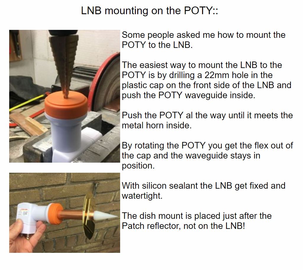

Post by g0mjw » Fri Jul 19, 2019 2:46 pm
What Dave Said...
Plus, you can use an octagon PLL and for DATV you do not need to modify it, save cutting a hole in the plastic cover if you want to use the dual band patch feed.
http://www.hybridpretender.nl/

Re: DRO ok?
Post by 2i0jmt » Fri Jul 19, 2019 3:15 pm
Thanks Folks
I forgot to mention, that I did do the cutting a hole in the centre of a normal Octogon PLL LNB thing, but had terrible results. What is normally a 7db MER+ on the Beacon ends up being around 4db MER :(
My unproven theory is that a POTY (with some type of lens on the front) is more familiar to a rocket LNB, than a normal LNB that effectively has its horn removed.
Are there any sources beyond ebay and amazon for good rocket PLL LNBs?
Jonny

Re: DRO ok?
Post by g0mjw » Fri Jul 19, 2019 3:34 pm
Thanks Folks
Jonny
How, exactly, did you mount the LNB? It is important the new lens is in the focus, (typically same place as the old feedhorn was). That's not so easy to do and generally requires adjustment in-situ.
Sawing off the horn is drastic, especially considering the investment at risk often exceeds €6, but it is the best way to go.
No. DRO only. The lens is easy to remove and re-purpose.

Re: DRO ok?
Post by 2i0jmt » Fri Jul 19, 2019 8:15 pm
I followed the exact instructions that you linked to :) Drilled a hole, and pushed pipe all the way back, and turned pipe to reduce flex.
I had MiniTiouner in front of me while I tried to make fine adjustments. The best I got was about 5dB MER max. I would imagine some non-rocket LNBs work better with a pipe than others. Mine is an Octogon Green PLL so if anyone has used a POTY with this LNB in this way, and has gotton better results, please let me know so I can try harder!
Cheers
Jonny
