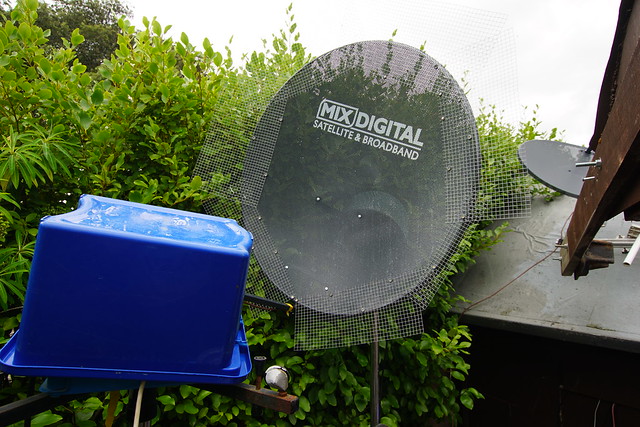

I would put your PA at the dish and your Lime in your shack. Put some amplifiers in you shack to feed down the cable. These small amps are cheap like the 8watt one that gets used by many with the always tx mod of two legs soldered together on one of the ICs. Even a dB loss can make a big difference.
The other thing that you don't mention is if you have looked at the transmitted signal from your lime directly as in across the shack.
I have a Lime and it works on a metre usb extention but that is only becuase it was handy to use at the time.
I have my 20watt linear and a PSU near the LNB and a Lime and a couple of small amps in a nearby shed. The Lime is driven by a windows PC running DATV Express. This takes video from vMix but vMix source is a stream from another computer in the house running vMix and using the vMix record streaming output. I can control the shed computer using remote desktop and the linear PSU is switched by a Hive remote controlled plug.
If you use a laptop running remote desktop to look at your main computer receiving Oscar 100, you can get close to your dish for alignment and tweeking without having to alter the cabling.
The blue plastic box is covering a smaller plastic box up the other way which has the linear and PSU in it. It keeps the water out (althogh I must put some drain holes in it just in case ) and the air still can cool the PA and fan. Not a permanent arrangement but it works!
Martin G8LCE
