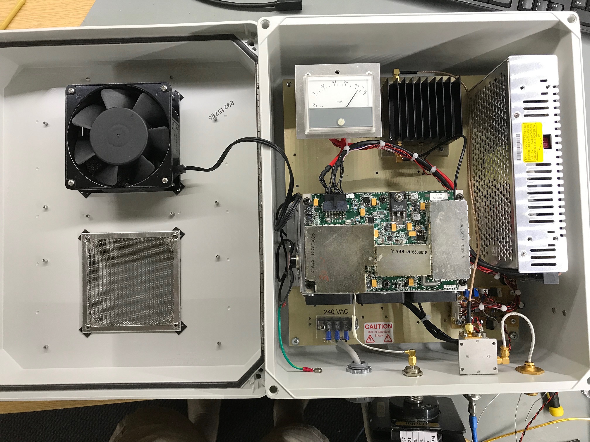

I did the snow flake mod and noticed that for -7dBm of drive I got 28 watts output with a current draw of just under 9A. Supply voltage set to 12V
Compared to before about 3dB more gain and an extra 6 watts output - flat gain across the es'Hail NB and WB input frequencies.
However I did find that after removing the PA cover (it was very stiff to remove) I had to bend all the little tabs back in to get an equally tight re-fit.
Initially the lid was snug but nor tight and it was leaking significant signal as I could see the PA current vary by about 0.5A depending on what was in close proximity to the PA cover.
Bending the tabs to ensure a really tight fitting cover solved the problem.
Here's a picture of my completed RF amp ready to mount behind the dish,

- IMG-0304-50.jpg (947.3 KiB) Viewed 8449 times
