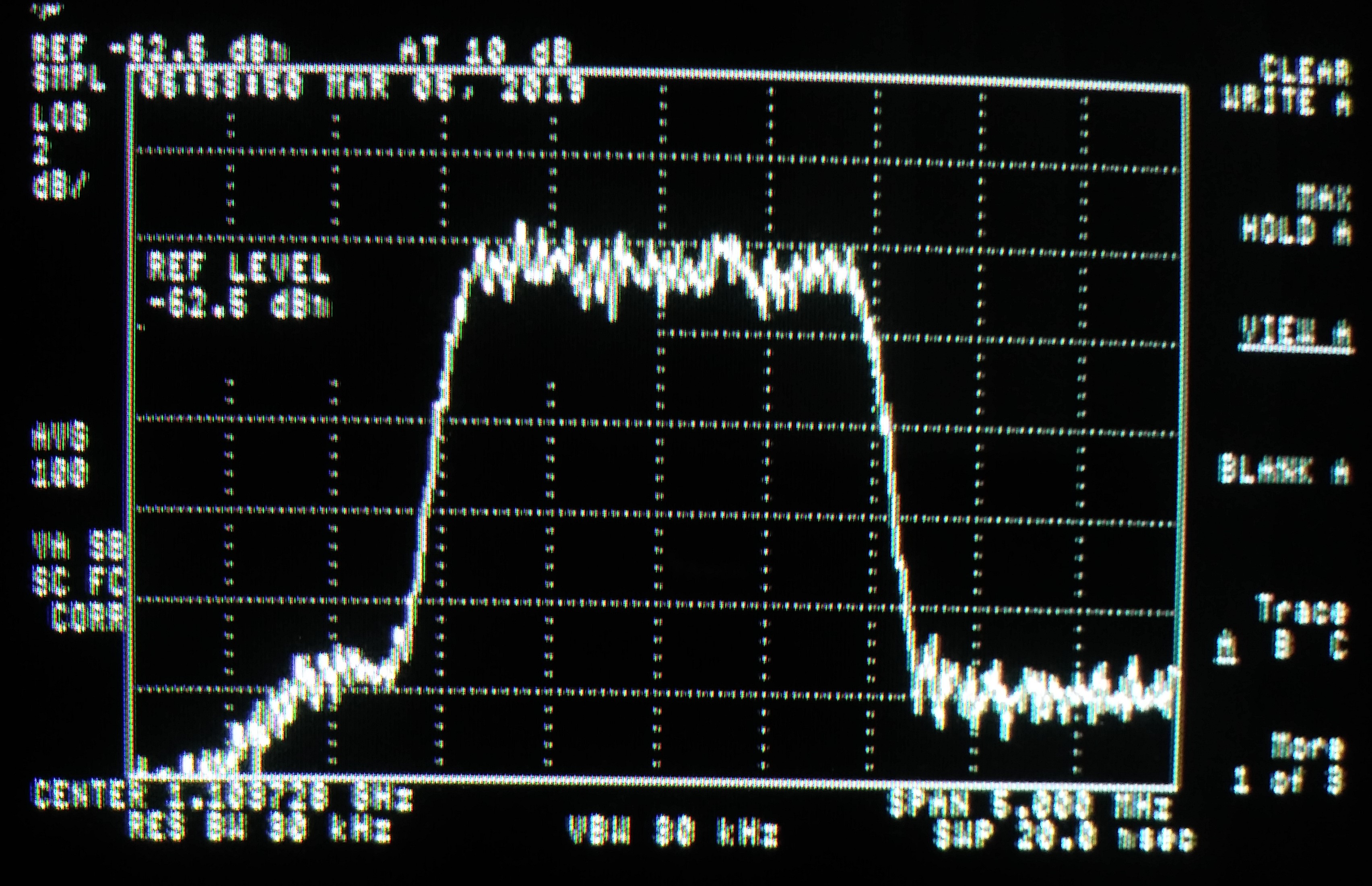

I think that the Goonhilly spectrum monitor provides a fair representation of the Wideband Transponder Beacon C/N. I've attached a photo of my spectrum analyser for comparison (1.2m, Octagon LNB).
The C/N that you see on the analyser is the result of the uplink C/N AND the downlink C/N; this is what determines the overall Link Budget. With the current Beacon uplink conditions, you could have the biggest dish and lowest noise LNB and you would only see an improvement of about 3dB ie the 8dB would rise to around 11dB or so.
If anyone out there has access to a 21m dish say, then they may like to try it ! 73

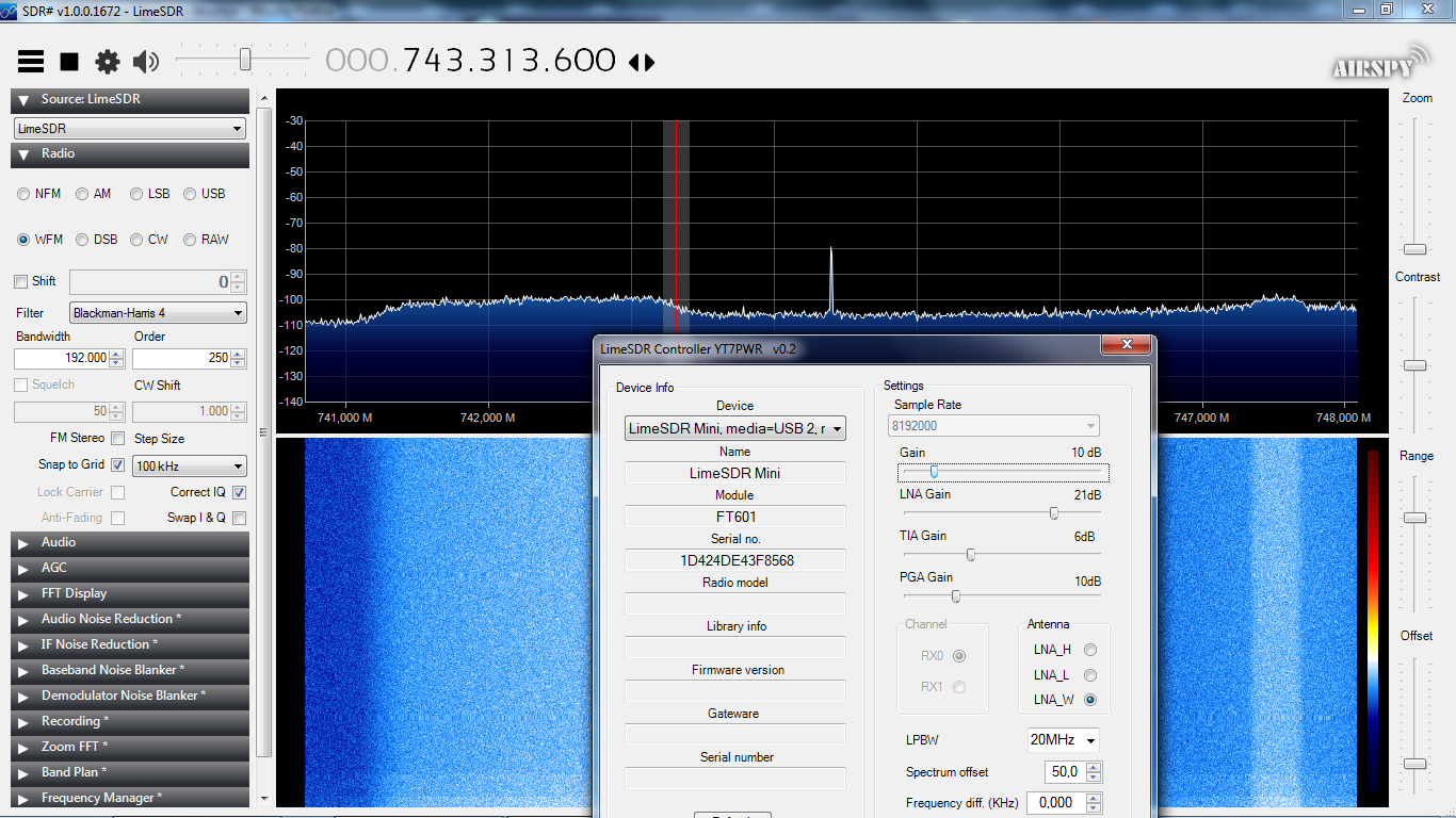

this is what I get with a LimeSDR mini and SDR#:
he large hump on the left is the 2MS/s beacon while the smaller one on the right (~747.5MHz) is a 333KS/s signal.
the spike in the center should not be there! the “Correct IQ” feature is useless.
now I have to try to enlarge/expand the vertical scale so that I can easily read 1 dB…
