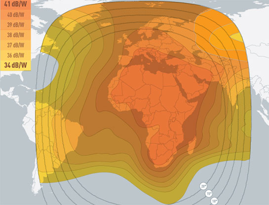

https://www.lyngsat.com/Eutelsat-10A.html claims a 40 dBW EIRP on that transponder for London. Here is the coverage plot https://www.telesatellite.com/images/sa ... frique.jpg which shows similar EIRP where you are. That should be a strong signal on a 2.4m dish - probably why you are looking for it.

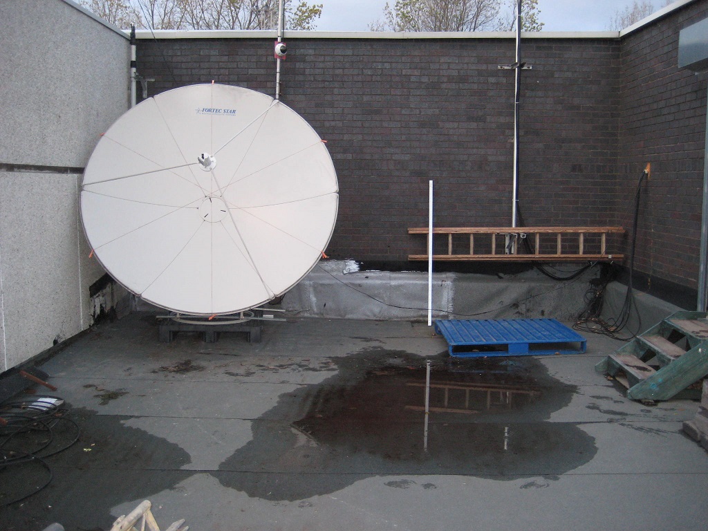

I used that method to try out the 1.2m Channelmaster that will be used for receive. It's hard to miss Astra.

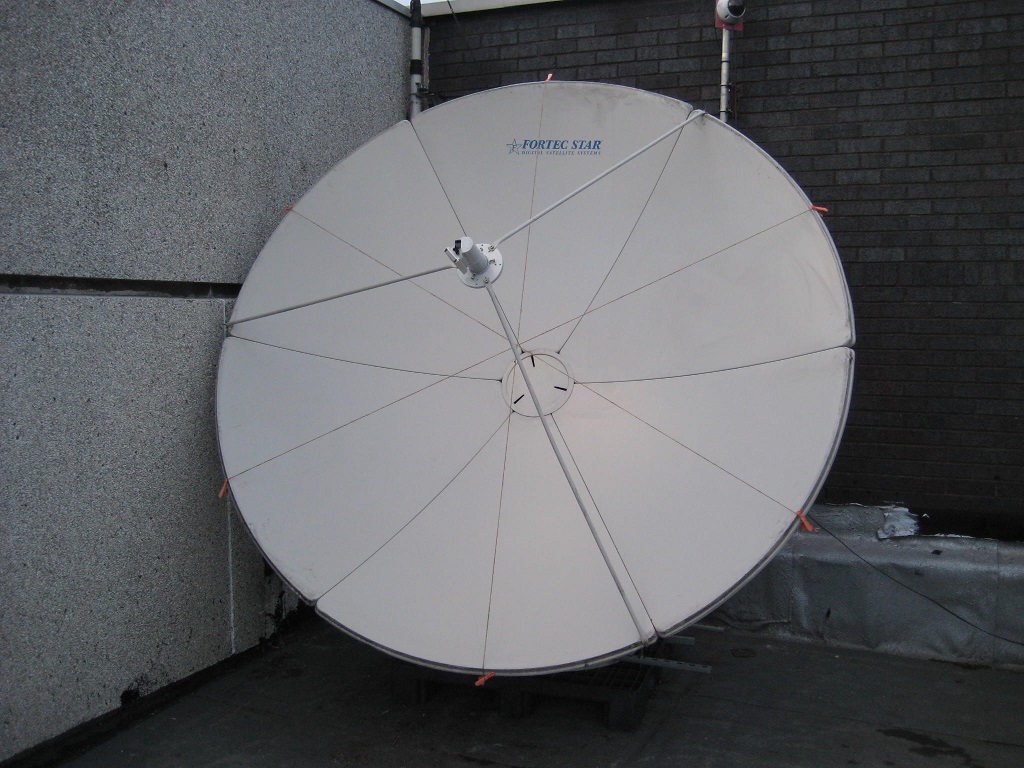

The 6 petal Fortec Star dish that we're using at G3NWR doesn't have a very good reputation: poor geometry, fragile and rust prone, to name a few. It's particularly not recommended for 10GHz, but people are getting reasonable results from them on 3.7GHz, so 2.4GHz should be even better.
The main attraction is that they cost one tenth of the price of a 'good' one, if you can still get them. There's a 2.4m version of the Channelmaster going for £2300 second hand on Ebay.

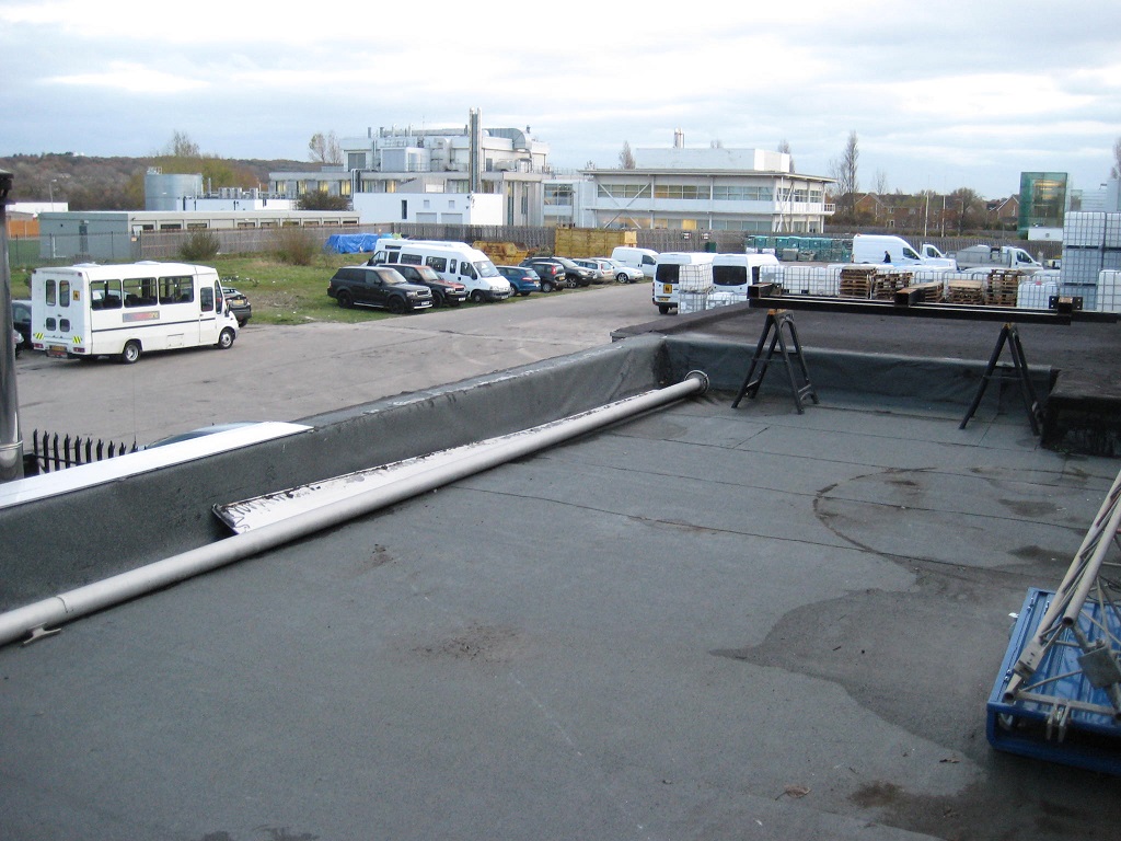

The dish still has the strings across it to check the geometry. It's within a few mm. It should be fairly well shielded from the wind and the takeoff to 26E is good.
