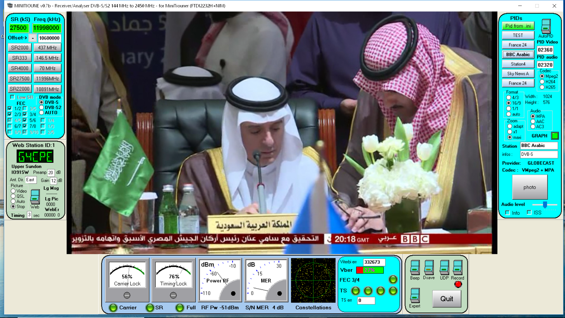

The signal from Badr4 is not strong but decodes well. I am using a old Sky LNB which is not particularly good but a 0.1db device is on order.
I am using a Technomate TM-5500 D satellite receiver and looping the IF output to the serit tuner. The broadcast signals use a high symbol rate of
27500Ksps which Minituone V 0.7 handles very well.
The picture is of BBC Arabic on 11996MHz Hor. 3/4
73 Arthur G4CPE

Thats fantastic, thanks Arthur.
I have a modified dual output LNB somewhere that I think I can feed directly to Mini Tioune.
One output is for SSB and the other for DATV.
I was wondering what size dish I would need and it looks like a 1m dish is going to be adequate from your picture.
