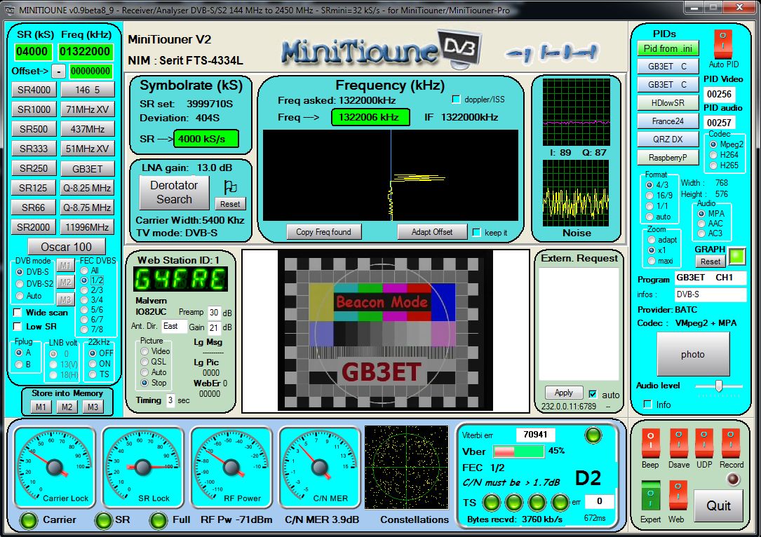

Just got back from microwave update in dallas and took a quick look. Found it instantly. MER of 3.9dB using a 23 element Tonna located in my loft (pointing East) with my G4DDK VLNA. Distance = 57km

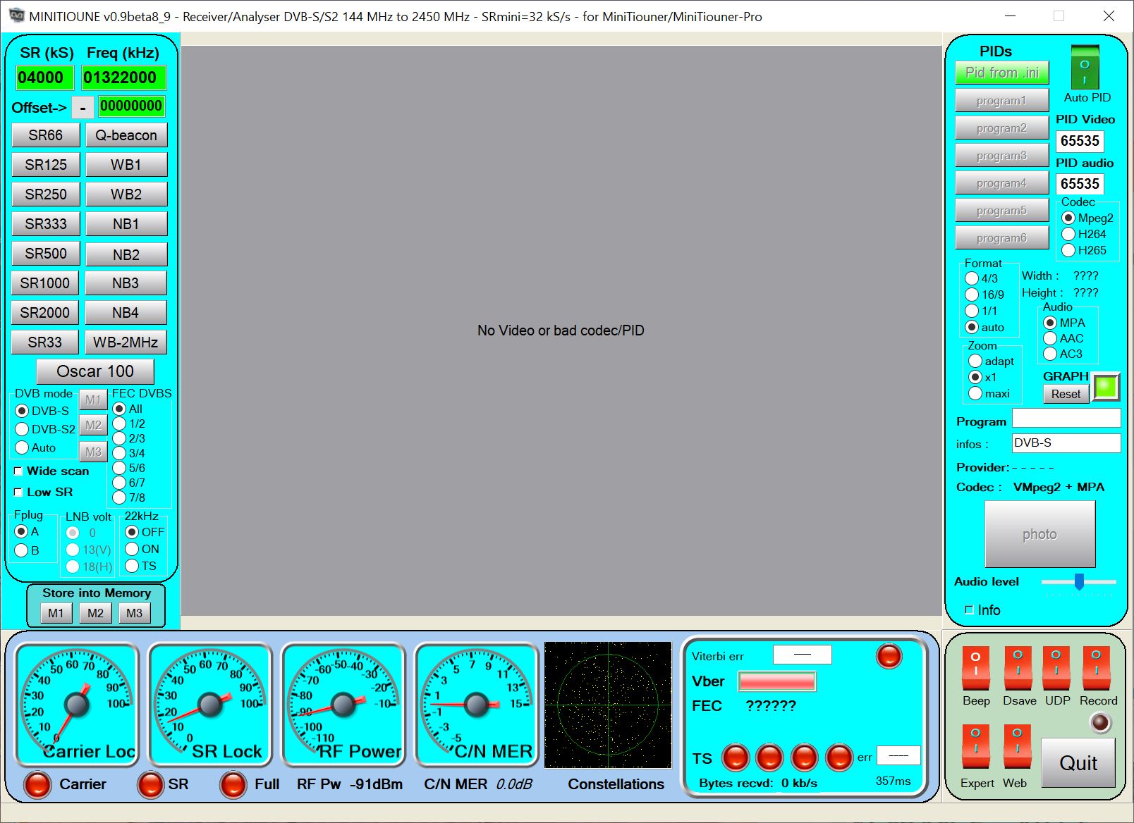

Hmm - hang on. Where did I leave that bias thingy... right masthead LNA, 55ele Tonna, in the clear, good take off 57k
Should be visible but it isn't

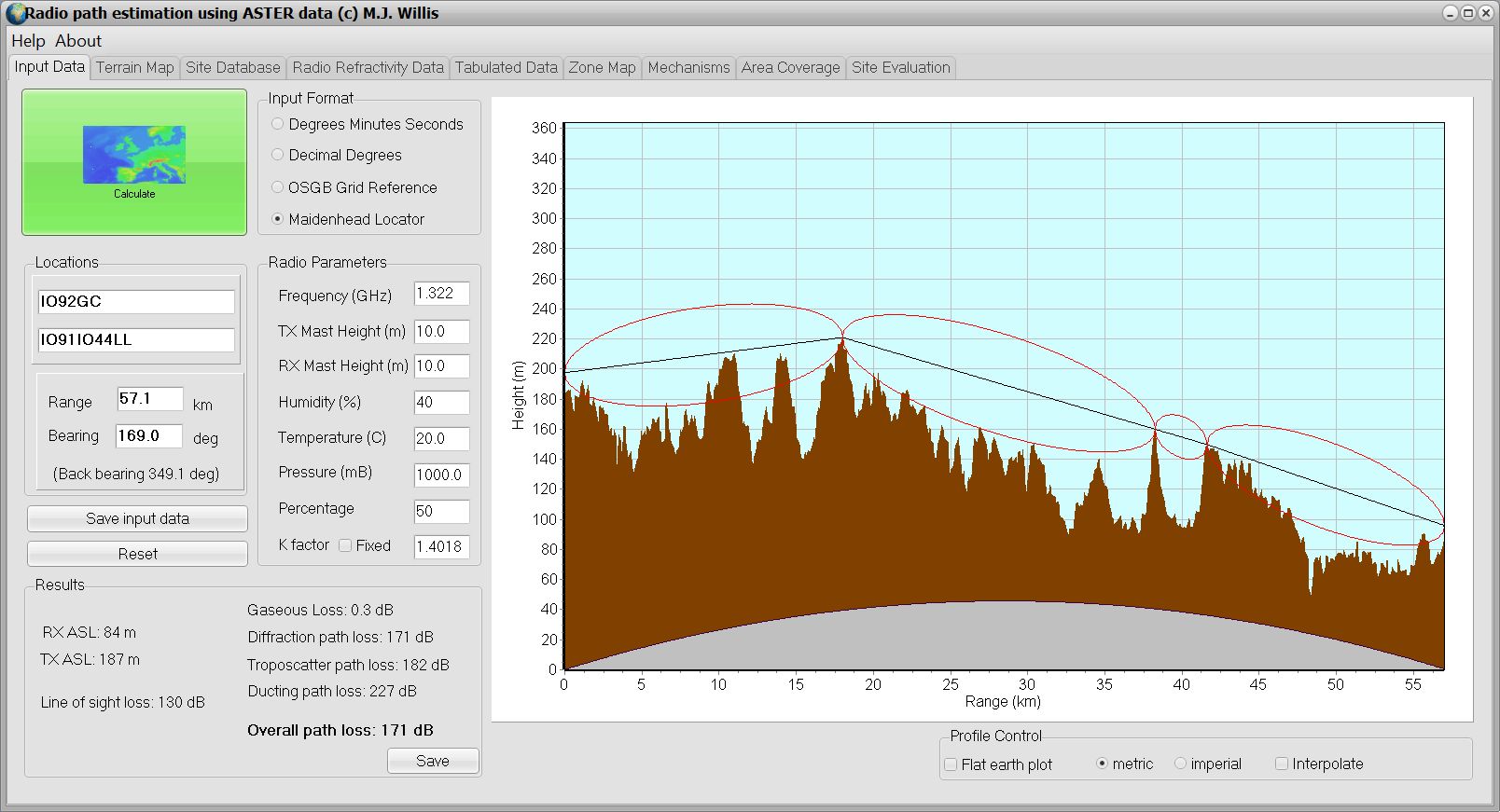

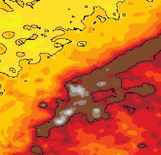

I found a more accurate locator for Edge Hill that explains why I don't see it, it's screened to the South as the ground rises to 270m - assuming the location is correct. That adds 20dB loss.

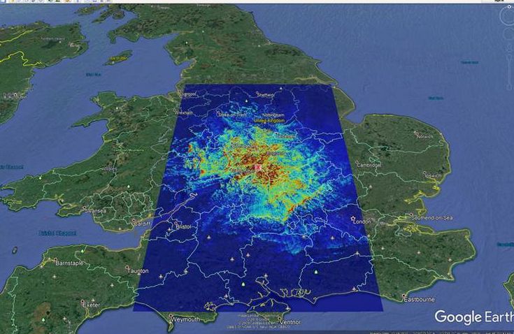

Having found an accurate location of the repeater and done another path loss calculation based on this I am now puzzled why I don't receive it. Would it be possible to post details like power and antenna gain? Are there trees in the way perhaps? If so it might get much better when raised to full height. I don't know the power or height but here is an initial coverage prediction based on 1kW EIRP and 10m mast.

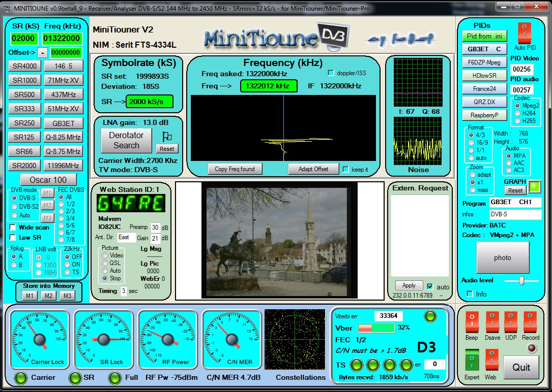

That could explain why my 4MS symbol receiver has not found a signal today! Now it sees the 2Ms signal

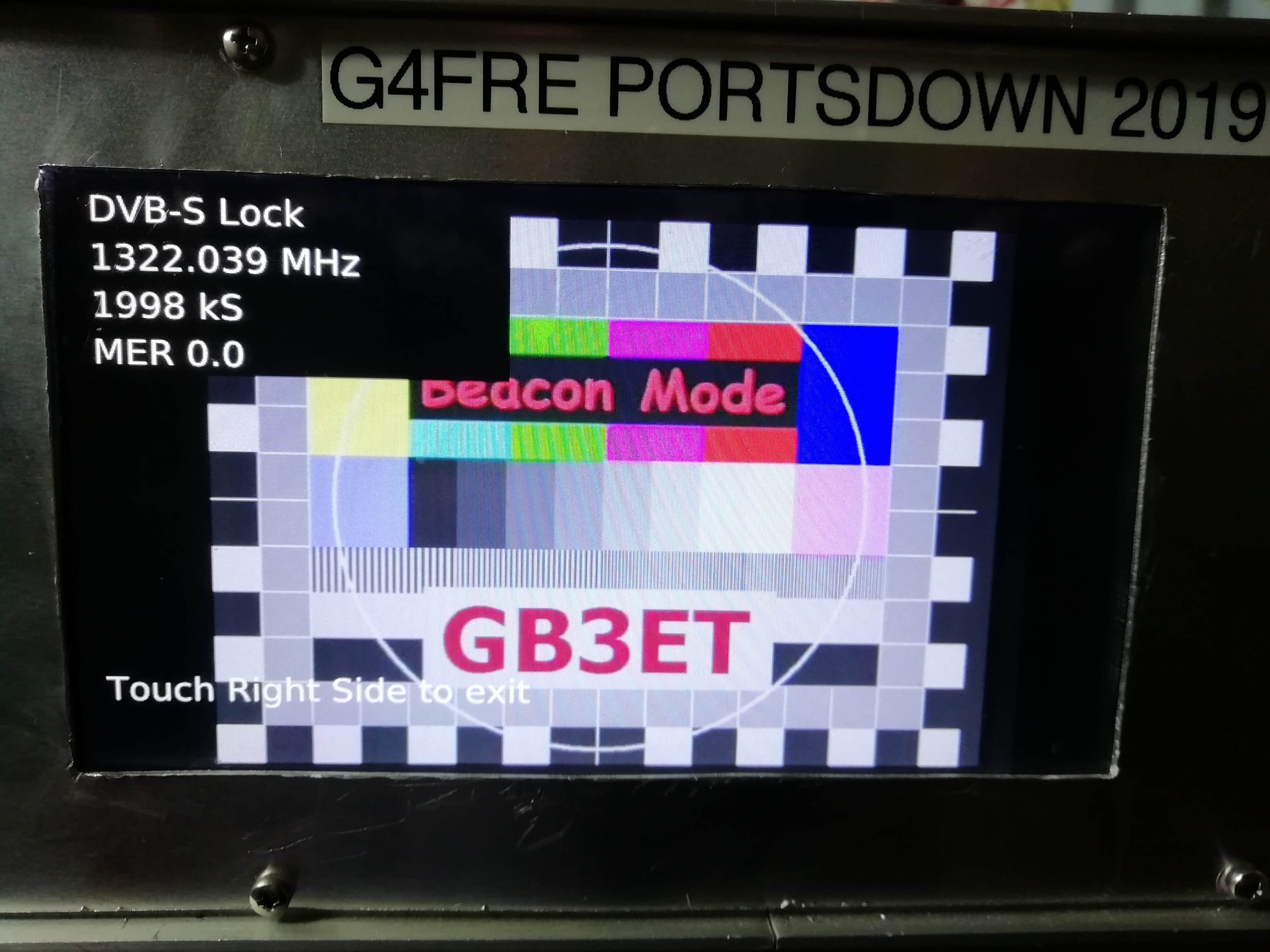

Now its down to 2MS I can even see it on the Portsdown/longmyndd setup
(note MER meter doesnt currently work on DVB-S)
