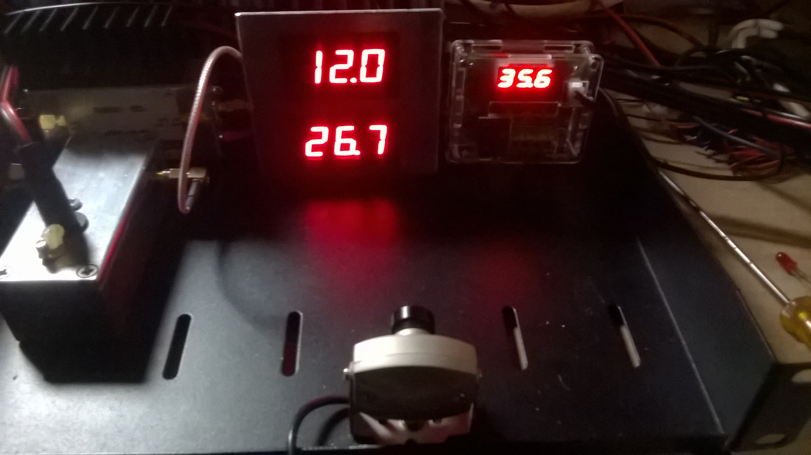

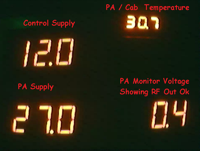

The attached picture shows an led display of voltages and P.A / Cab temperature.
The image is from a small video camera about 10cms away, lens making flat surface curved...
We were Txing this on second channel but at 2M/S pushing our luck.
The display can be accessed remotely, and also displayed via ET stream.
If the seperate 12v PSU supplying receivers fails the controller goes to "Beacon Mode" and overlays this on repeater output testcards.
The original control software was designed by the late, and missed, David G8OBP for GB3GV at Markfield Leicestershire.
Thanks to GB3ZZ for original video monitoring idea :)
Peter
