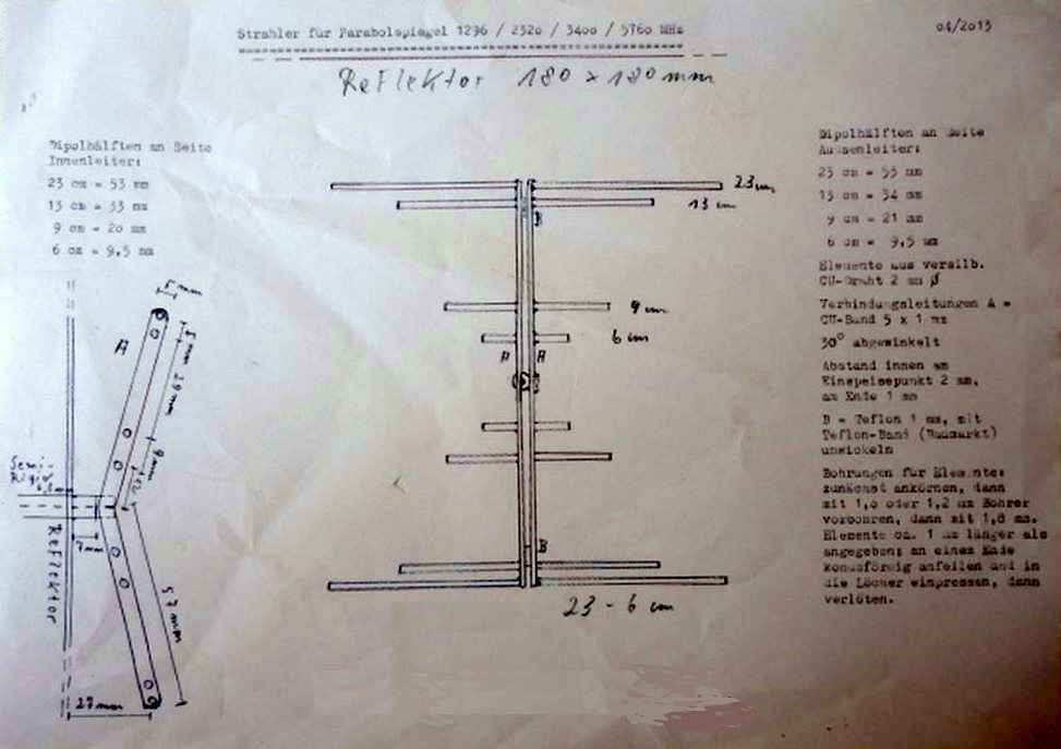

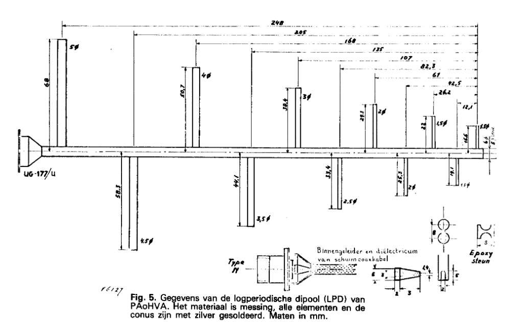

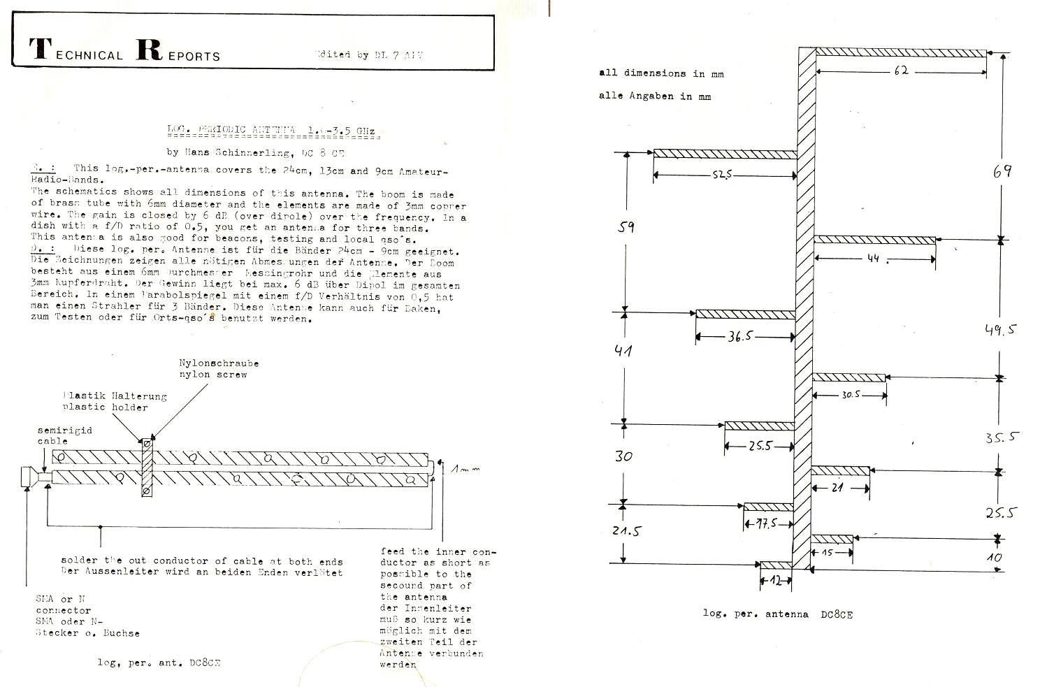

In the article about dishes and their feeds (page 14) several designs are mentioned. If you are interested in the mechanical dimensions of the stacked dipoles or the LPA's: please see the pictures below. For pros and cons: read the artickle in CQ-TV :)

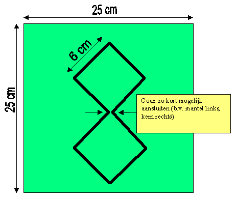

Another great issue to enjoy :-) I have a question about the bi-quad design, all the www guidance suggests that distance from the reflector affects VSWR. I've built one for 24cms and whilst clearly 'resonant' at the design frequency, its a horrible match (over 4.0:1) that doesn't change much with reflector distance. Wonder what I'm doing wrong?

Sweep your test frequency Gareth - i suspect you'll find it's not resonant in band. The better the match, the more sensitive will appear the change in match and you move the antenna towards and away from the dish. That effect is inevitable because of the non linear nature of the return loss figure, being as it is a log value.
I agree with Bernie. Or something is completely wrong, like crossing in the centre.
With the following design and 3 cm distance to the reflector plate, it should work (23/24 cm band).
Small adjustments could also be made by stretching the square a bit.
