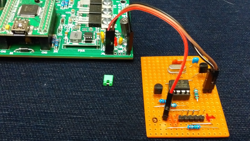

Works very well with MiniTioune, but I find it necessary to power cycle the board after starting the RX, maybe a longer delay before the code is sent would be better in this configuration.
EDIT
I have just tested six other SUP2400s and they all work perfectly, no need to reset. The first one I used is just slow to start.
Typical I would pick that one first!
