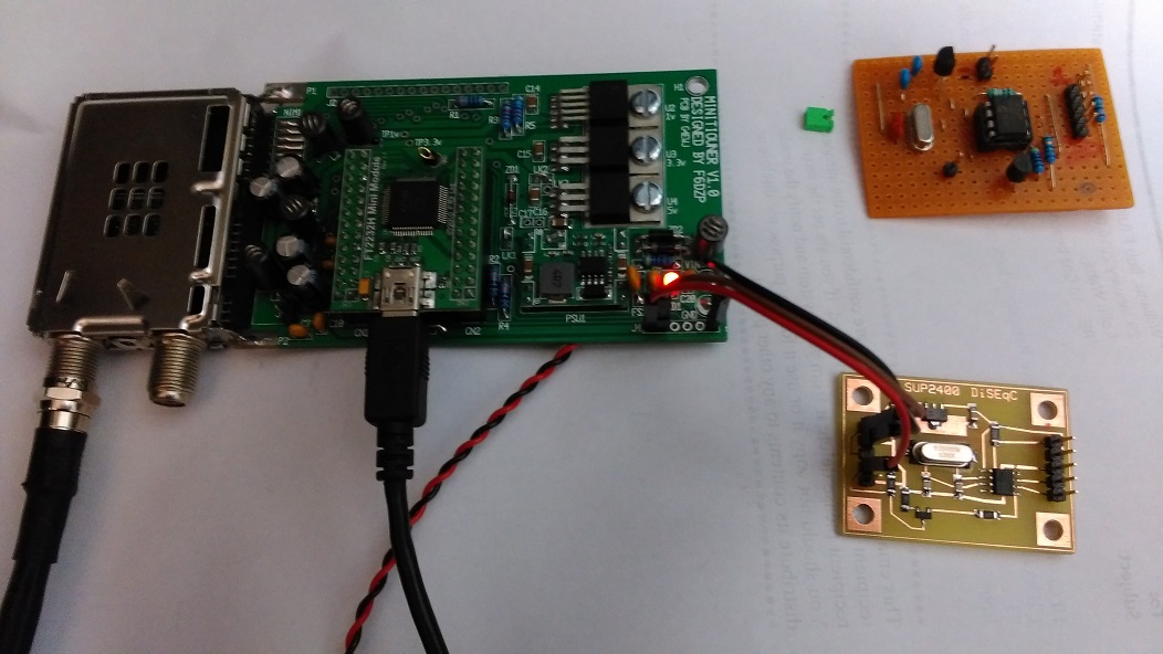

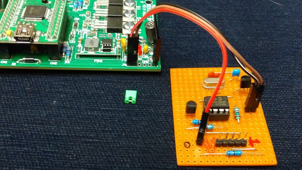

Not using the second LNB or bias tee, just removed the link that sends 12v to the LNB, used the supply side to feed the circuit and fed the output back to the LNB feed, there is also a ground connection on the same header, all very neat and easy :D

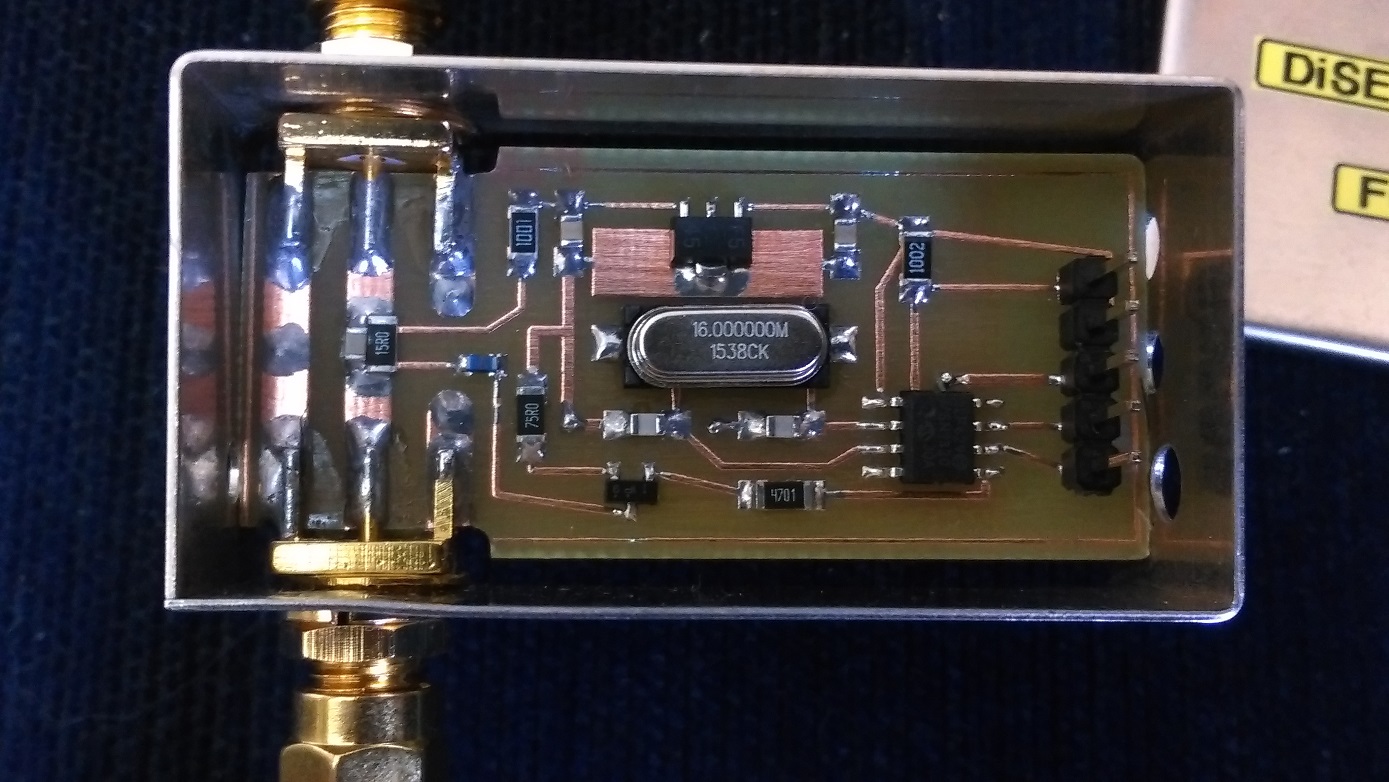

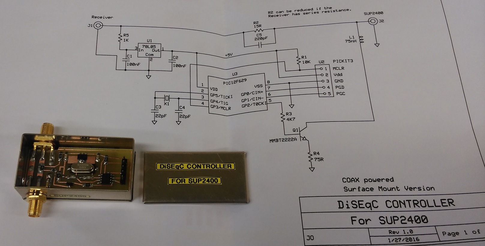

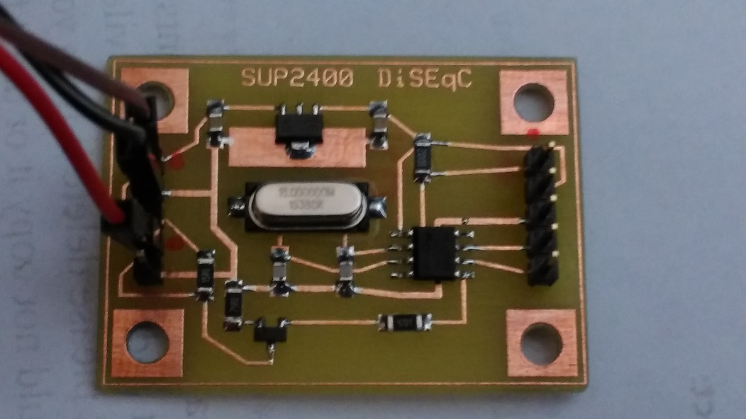

Same thing but surface mount for those of that persuasion :D , Thanks John for the layout.

Post by RonM » Sun Feb 14, 2016 3:57 pm
Nice board!

Post by G4KLB » Tue Feb 16, 2016 12:20 pm
Thanks Ron, You have started something now!
Really pleased you sent in that CQ-TV article.
Thanks to John who has done all the PCB design work for me to try. 8-)
This version works for a standard Sat RX.
I would like to try a version with a longer delay to see if my slow to start SUP2400s work as well.
If I reset the circuit they all work.
