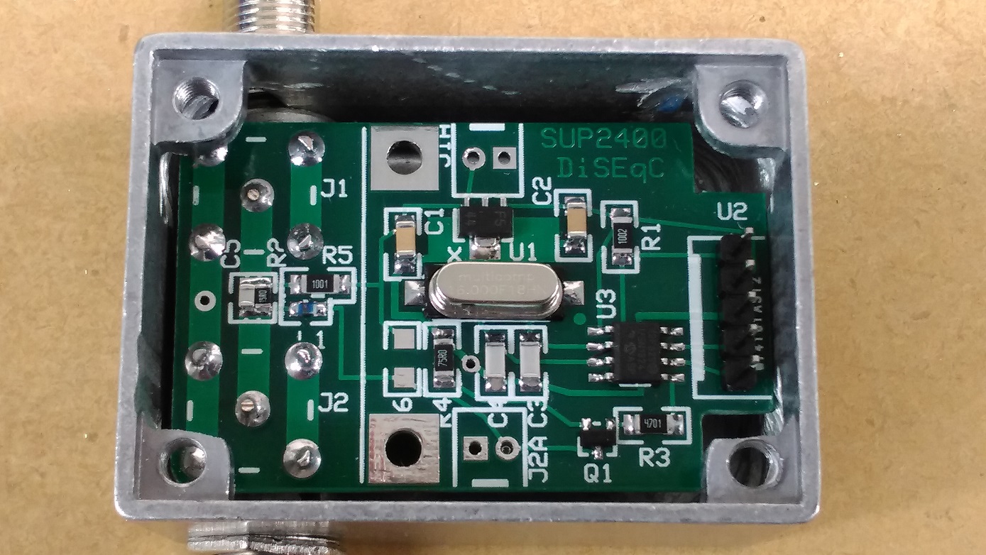

Mike,g0mjw wrote:... Changing the crystal isn't easy but not impossible. In retrospect, it might have been better to destroy it with cutters as that would make de-soldering less likely to damage the PCB tracks...
I lucked out on this point, having just seen a video on YouTube (https://www.youtube.com/watch?v=7kyaz4Zrd78), evaluating an SMD removal kit. The demo featured using the removal kit to desolder a 208-pin QFP chip. It depends on a patent alloy, supplied with the kit, which lowers the melting point of the solder already present so that you can get it molten simulataneously on all 4 sides. It's not the most dextrous demo but it illustrates the point.
Given the apparent inaccessibilty of the solder on the crystal in the SUP2400, I thought that I'd give it a go there. I first chopped the earth connection with a pair of cutters and then, after the third cycle of heating each connection in turn, the crystal just fell off the board, with tracks and crystal undamaged!
The kit is a little expensive but you don't use that much of the alloy on each job.
A bit late as a response but I thought I should report it anyway.
73, John.

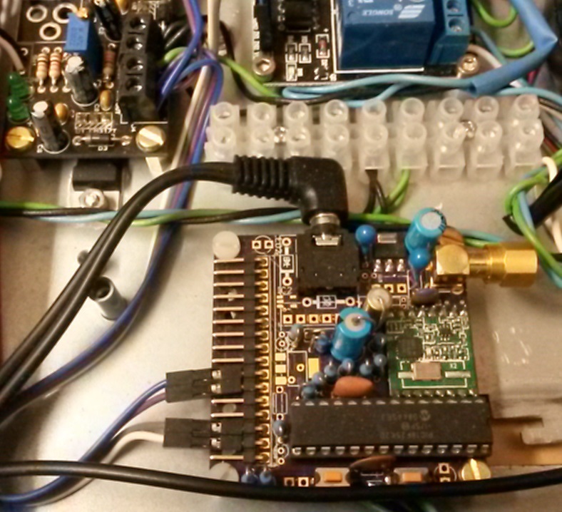

Hi Chris,
I am interested, please post your DiSEqC code for the PICAXE.
I use a PICAXE 28x2, as a sequencer in a 70cms PA,
so interested to see if I can fit your DiSEqC code in too? This board started life as a telemetry GroundStation for Eagle2.
There was a PICAXE 40x2 onboard the Eagle2 satellite.
Dave - G0EID
Dave - G0EID
